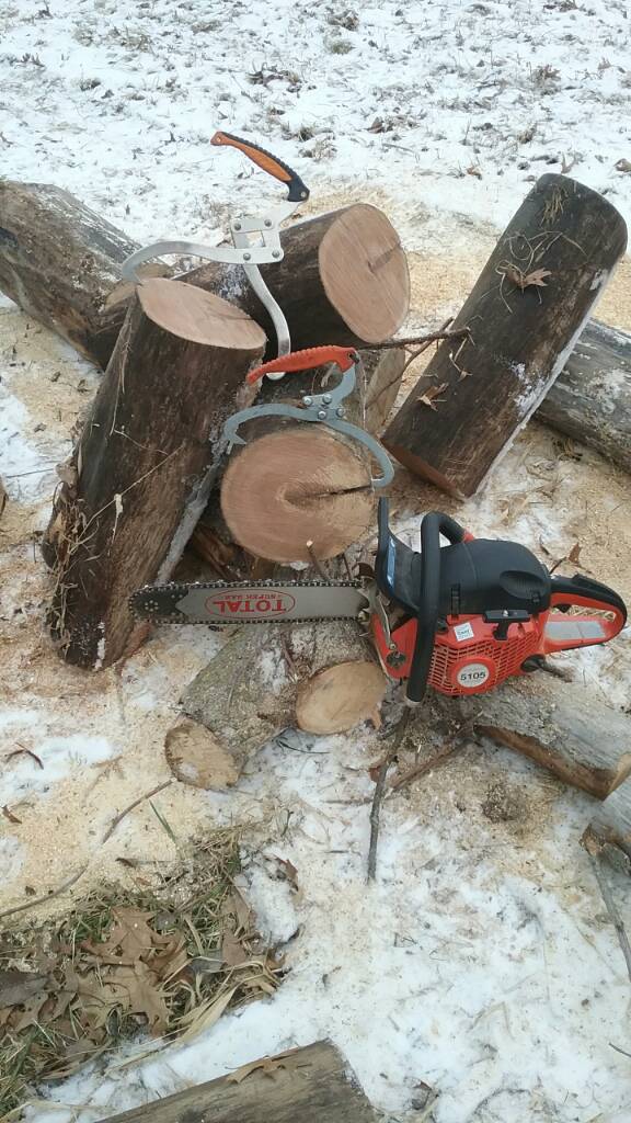

Running a 16 inch 3/8 On my 5105. Pulls it easily.

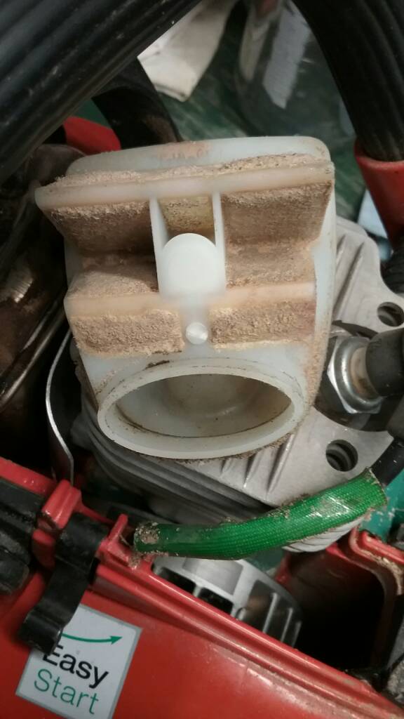

Have any of you used the nylon screen type air filter on your 5100/510/5105's? I have the flocked type and find it loads up easily and starts to diminish performance. Just thinking the screen would be easier to tap clean. Mine is this kind:

They work good as long as you clean them. Not recommend for people that don’t take care of there saws. Lol.

I am no expert, but my 510 came with the black framed nylon filter. After 2 tanks in dead ash, with a brand new sharp Oregon it was scary to look inside the intake boot to the carb. I can't imagine a dull chain with fine dust. It has been replaced with a flecked type.

Coating the seam of the black filter with grease helps a lot. Pop it open as shown on page 33 of the Canadian manual's English section. The pop open nubs are easy to miss if you don't know they're there. It's also easier to blow out the screens when it's opened.

I stayed with the flocked. If the dust is in the flocking it ain’t in the carb.

So true. I guess I'm accustomed to the Jonsered/Husqvarna spin filtration system and I hardly ever need to clean those filters. I'll just wash it a little more often.....

When I clean them I take them apart and spray them with brake cleaner from the inside out then carefully use compressed air to blow them clean from the inside out. I said use the compressed air carefully because at full pressure you can blow a whole thru the filter. Ask me how I know.

I read once about using starting fluid to clean the filters. I use it all the time now, and seems to really get the dirt out of them without ruining them. Open the filters if possible and shoot the ether through the backside to reverse flush the crud out of them. It dries fast and is cheap to use.
