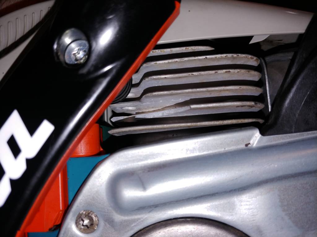

A little project tonight. Installed a reduced weight cylinder and some other pieces and parts.
