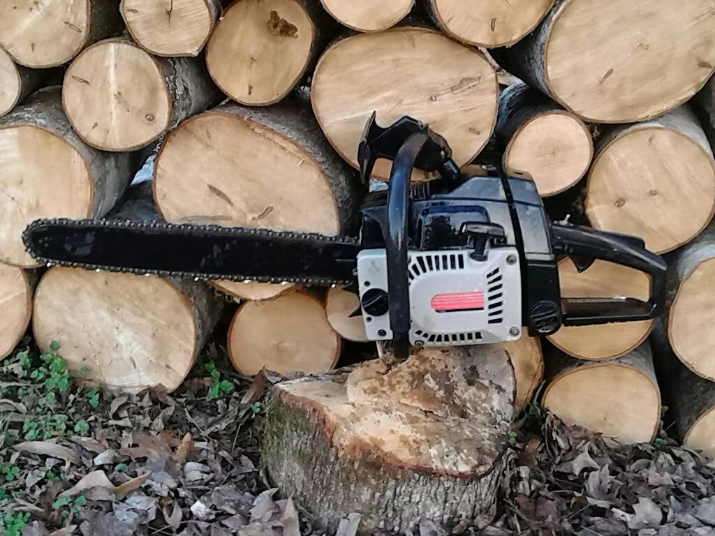

Looks like mine
Steve on Tapatalk

Was thinking on bumping mine up to a 3300 but decided to leave it like the way it came. Has cut many cords with that saw and never let me down when I was running it.
Steve on Tapatalk
