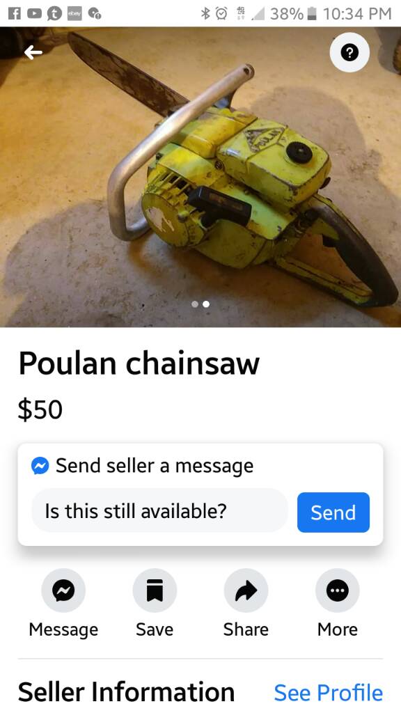

Found you something dream, in you neck of the woods.
Steve on Tapatalk
Thanks Steve. I'll check it out.
Old and loud, two of my favorite qualities in a saw. Third being heavy, but I dont like that part as much.

Thanks, Saying I do not have permission to view this page or perform this action though.
