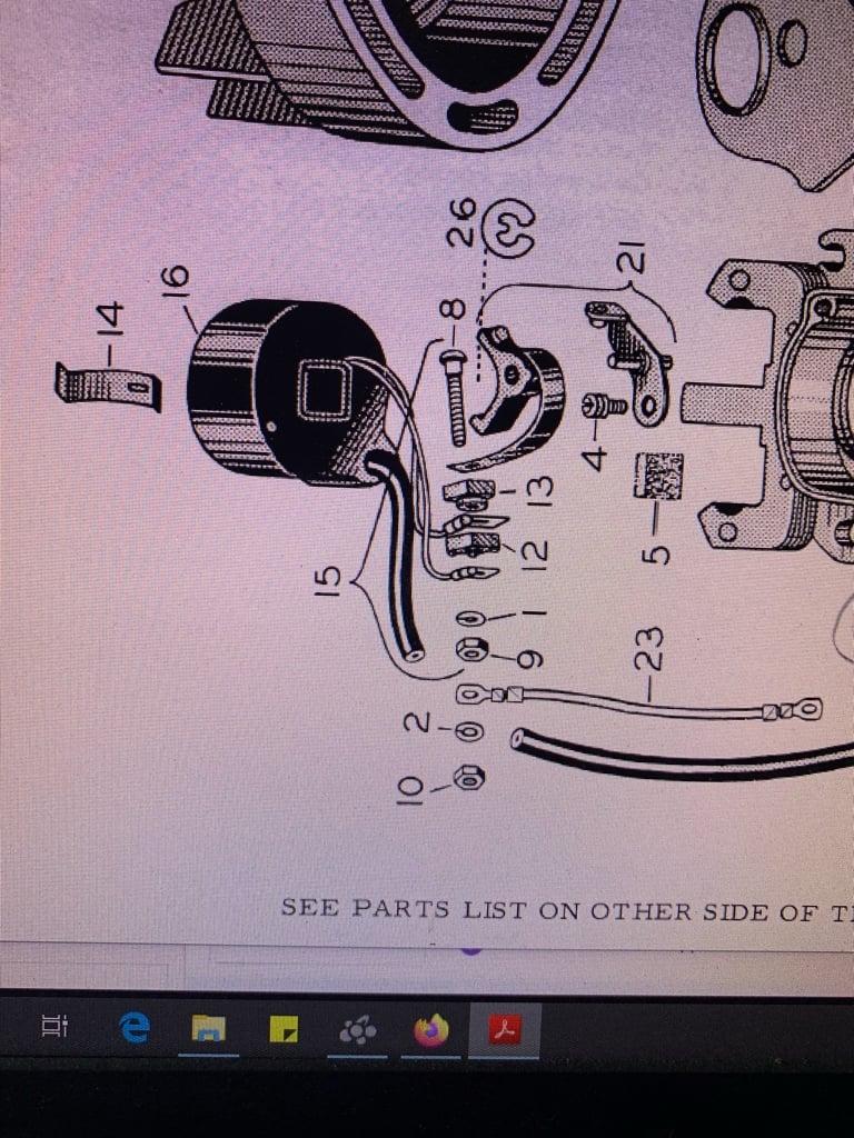

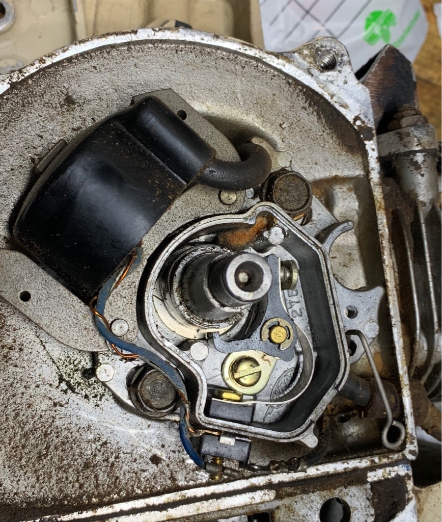

After figuring out that the blue wire from my Model 47’s coil was on the wrong side of the black insulator block, I got a great blue spark which was the original problem. Next, the reed valve block had been installed upside down, resulting that the impulse port could not line up with the carburetor. Got that straightened out, and the neighbors got to hear another loud Poulan go after some wood!
