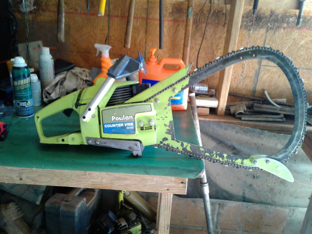

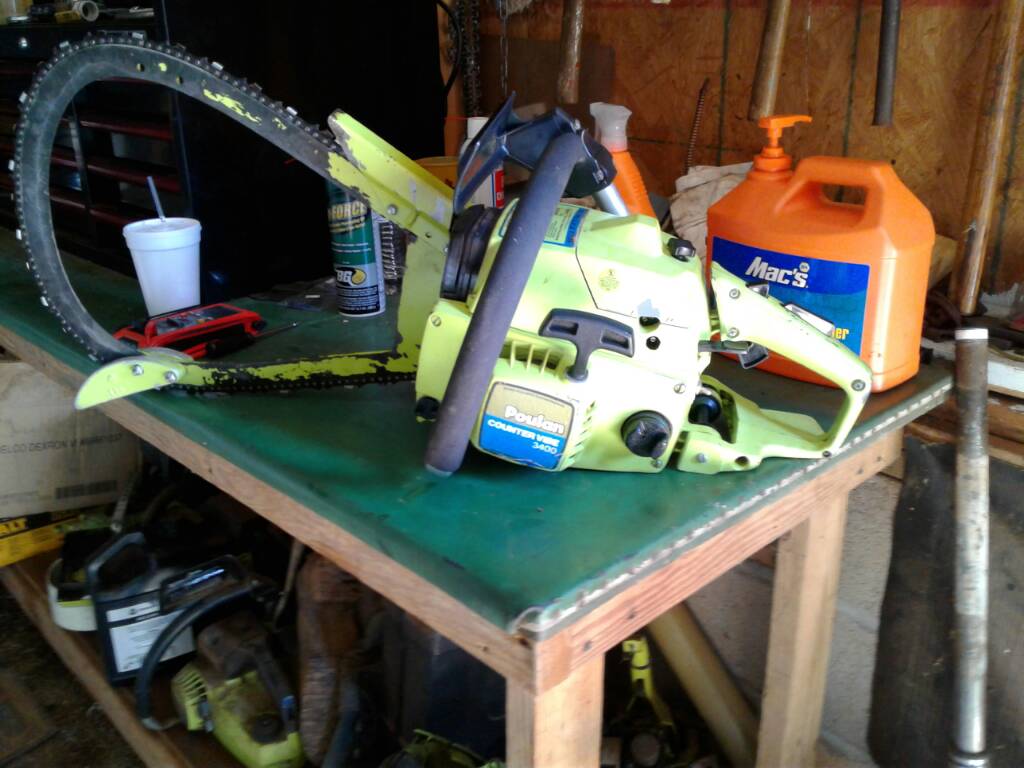

Still don't know why the lower brace is bare steal, no paint on it any where. Bow is factor to the saw, 14" bow on this one.
