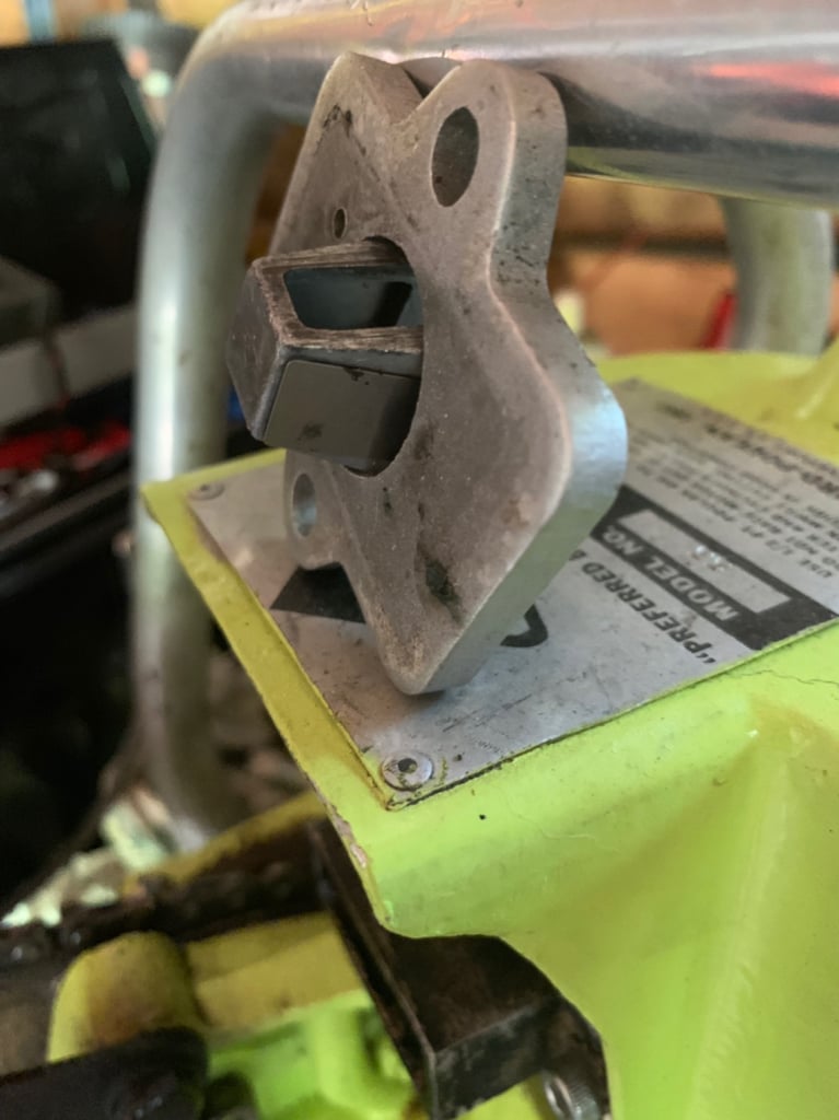

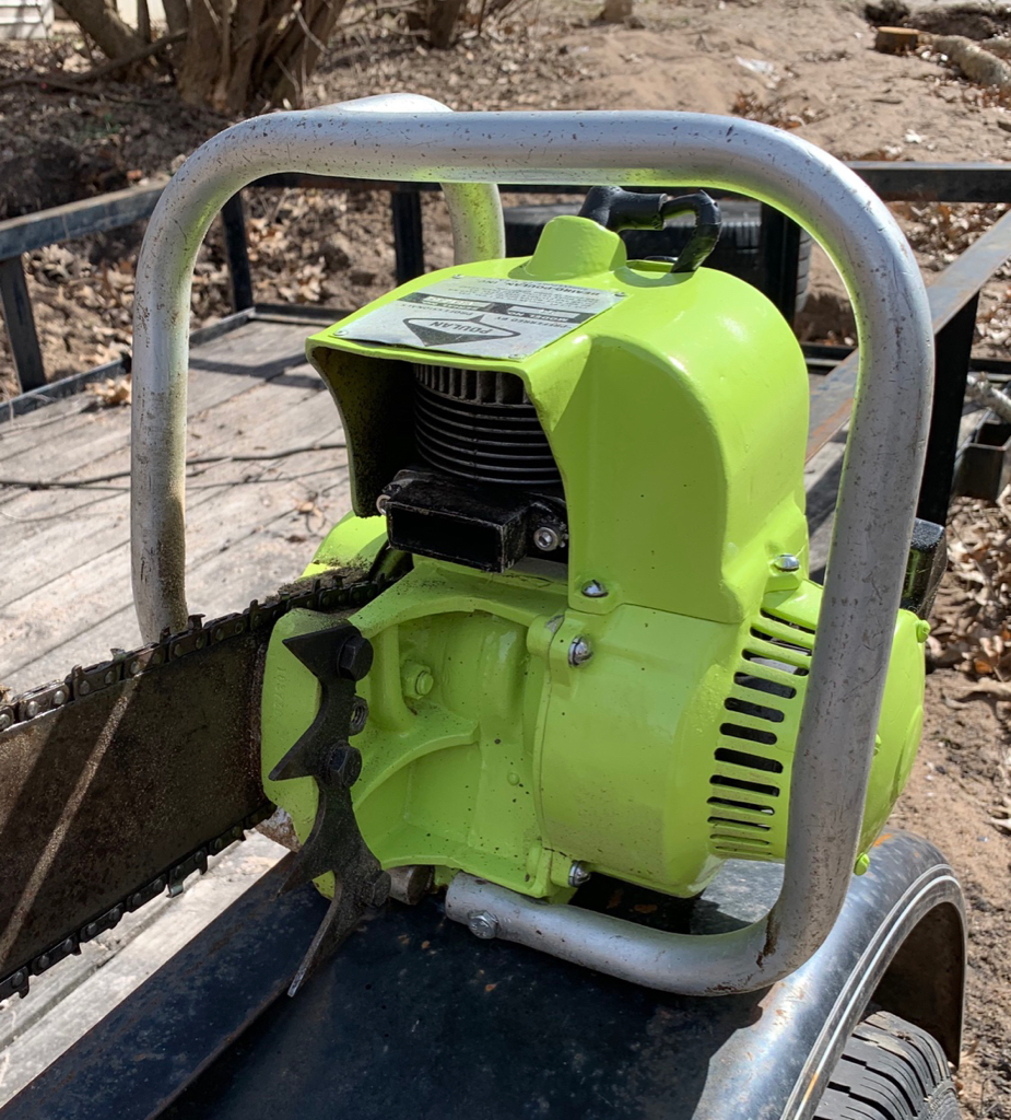

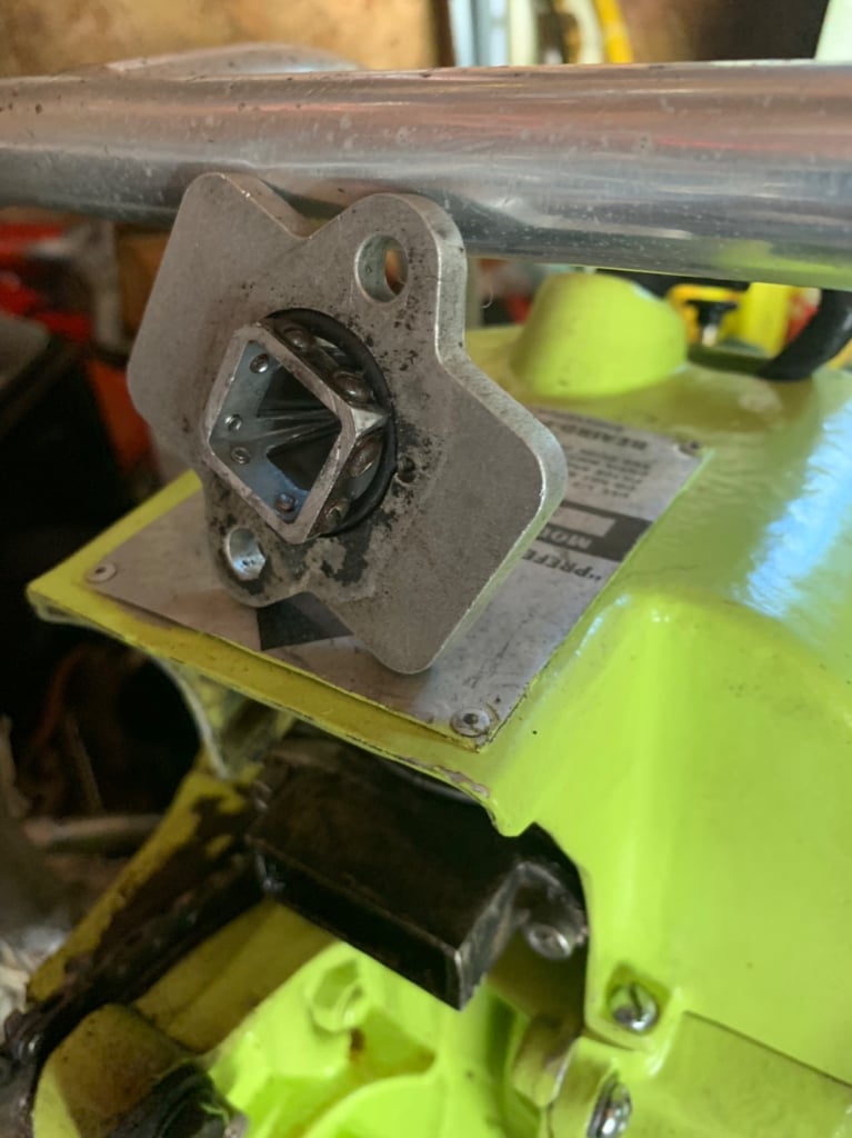

The Green Nasty Model 53 hasn’t run any length of time since Spring. I had tried all sorts of things to get it back running to no avail. It got new rings, rod needle bearings, seals, carb and carb rebuild, points and condenser, but not a whole lot of change noted. I finally was able to buy a different reed valve block on eBay that looked like the type my 43 has and thought it might swap. I knew the old one had a reed petal that didn’t quite seat so for $12 it was a go.
After pulling the reed block I discovered more than a petal not sealing, but actually missing a petal completely!
So after the different reed block fitting perfectly, it starts on 2 pulls, idles, and runs great. Still makes enough noise to shame any of the neighbor’s ideas of motorcycles to boot!

Soooo, um, did you happen to find the reed petal that broke off maybe?
Seems like a dumb question to ask, but it could be quite the troublemaler if left in there to wander about.

Missing reed would make for a running problem, not quite a bad as not seating but missing, that bad. Time you you to go reed fishing.

I looked for it when the reed block was off. It opens up the whole backside of the crankcase and I couldn’t see the missing reed. Do you know of any way to maybe flush it out?

Well, I dont think its magnetic. If it was, id try running a magnet around in there to see if it comes out. Maybe take the reed plate back off and pour some mineral spirits in. Shake well, and dump out. Dont forget to follow up with a good dose of 2 cycle oil or mix to recoat everything with the oil film.
Its gotta be in there somewhere.

Might be stainless steel, it don't rust. That pedal has to be somewhere, don't think it made it to the piston. Unless, unless the previous owner had worked on it and found it, removed the piece and put it back together. Then couldn't find a replacement and decided to sale the saw. I'd still look any way. Better safe than sorry.

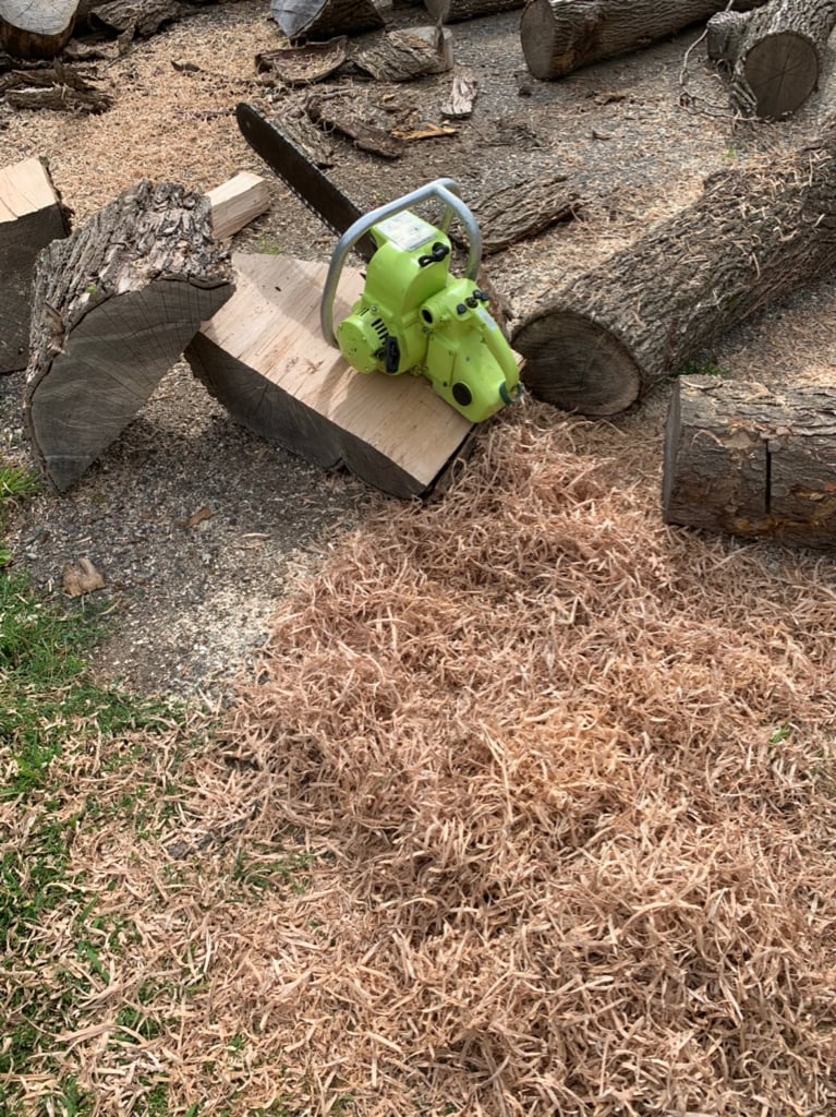

Checked and didn’t find the reed , so took it to a friend’s place and inflicted a lot of damage on some Maple and Ash blocks. Seems to have lots of power to pull .404 chain like it does.
