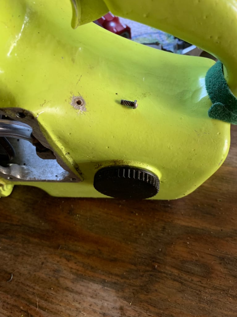

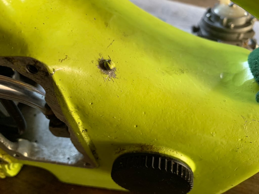

Been working on my old Model 53 sand cast off and on for 2 months getting it restored and cutting.
It wouldn’t run good enough to cut at the IA GTG, so I changed clutch springs and fixed the starter recoil. Then it started going lean in a small log so I went after the carb and rebuilt it again. Now it’s puking fuel out of the carb and I traced it to the vent which is just a screw into the fuel tank. The inside of the tank had a varnish like coating that must have plugged the vent. Pressure testing the tank showed holding 15 lb. so I figured I better get the screw open. Small vise grip got it twisted out finally.
Took a pin to clean the varnish off the threads. Now it will breath both ways and no pressure buildup.
Plus, every time the carb has to come out of the worst possible place on any saw.
I’ve done it so many times that I’ve got it down to about 10 minutes from scratch.
The left side is the worst as the recoil and covers have to come off for access to the nut and not much room at that.
Still not right, so I’m thinking maybe the reeds are leaking, I’m keeping at it till it’s fixed!

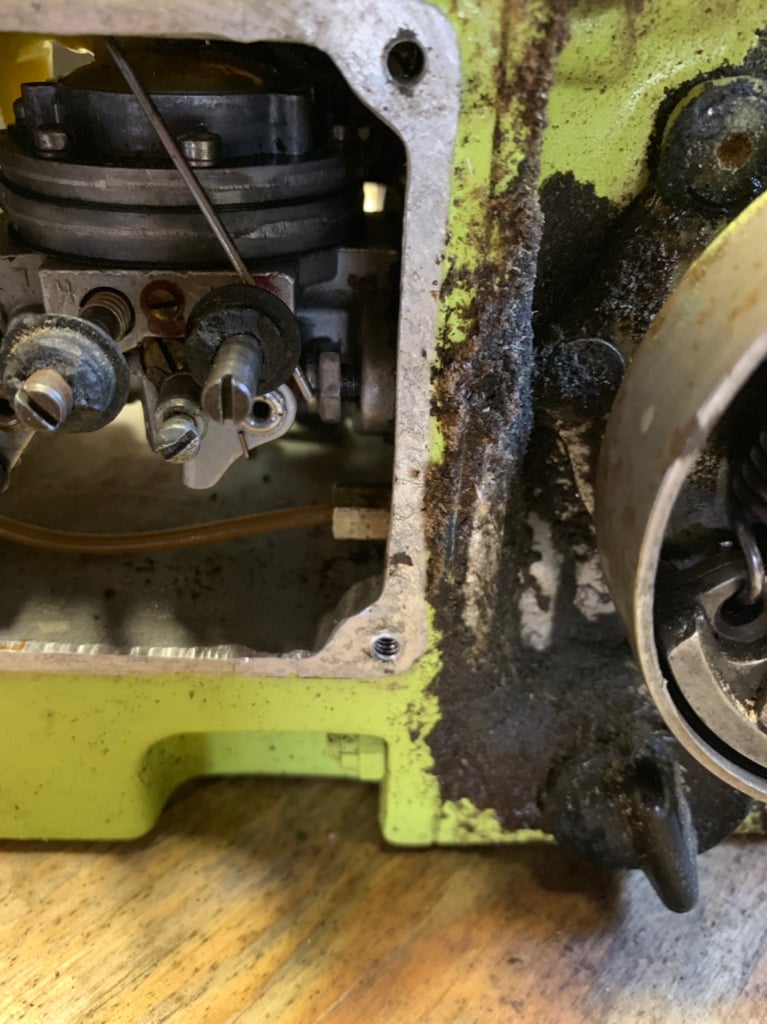

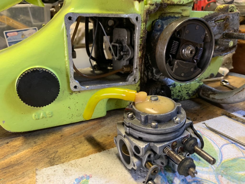

Hi folks,
I have a Poulan XX on my workbench, actually she's labeled DOLMAR hobby 100, and she's missing the entire fuel line including filter head.
I have already managed to install a new fuel line without opening the crank case and will add a 12 mm ø aftermarket filter head, but what I need to know is how the fuel line is routed from tank to carb: Below the flywheel or above it and then turned around the right side of the carb to its bottom fuel connector?
If I remember below the flywheel underneath of it along side the coil wire, the bear is the Oiler system and line that goes in the crank case for pressure. If you need that the case will need to be split.

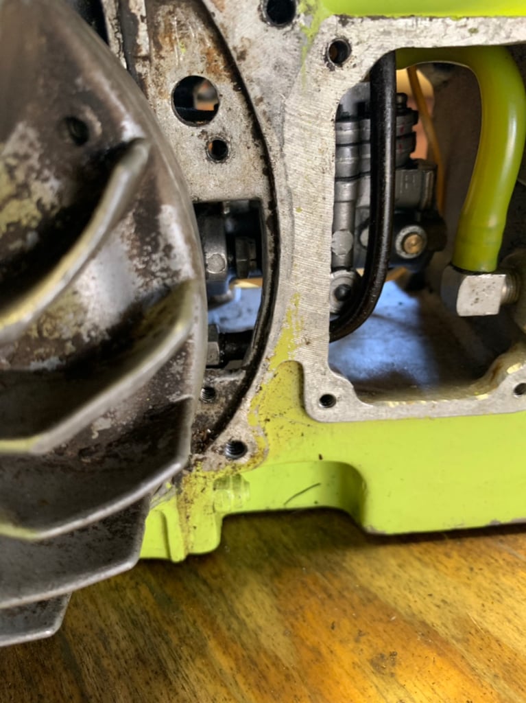

Thanks for the hint!
I have removed flywheel and starter recoil and reckon this should be the best route, as @acornhill recommended:
However, there is no oiler system on the flywheel side of the saw, both lines are being held down by a tin disk to prevent them chafing at the starter recoil:
Could have figured out myself :eusa_doh:

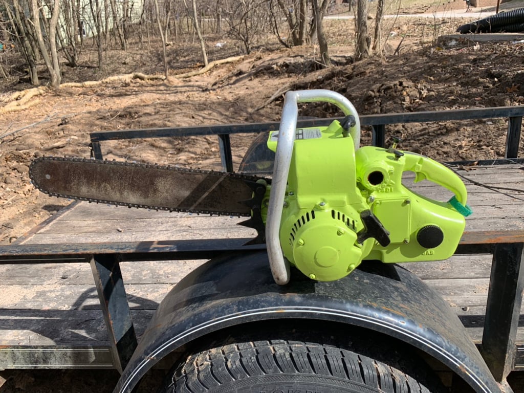

My new $80 addition to the stable. Got it pulled down for a full inspection. Looks to be low hours on this one. Still had dino oil in the carb so I believe it's been sitting for awhile.
