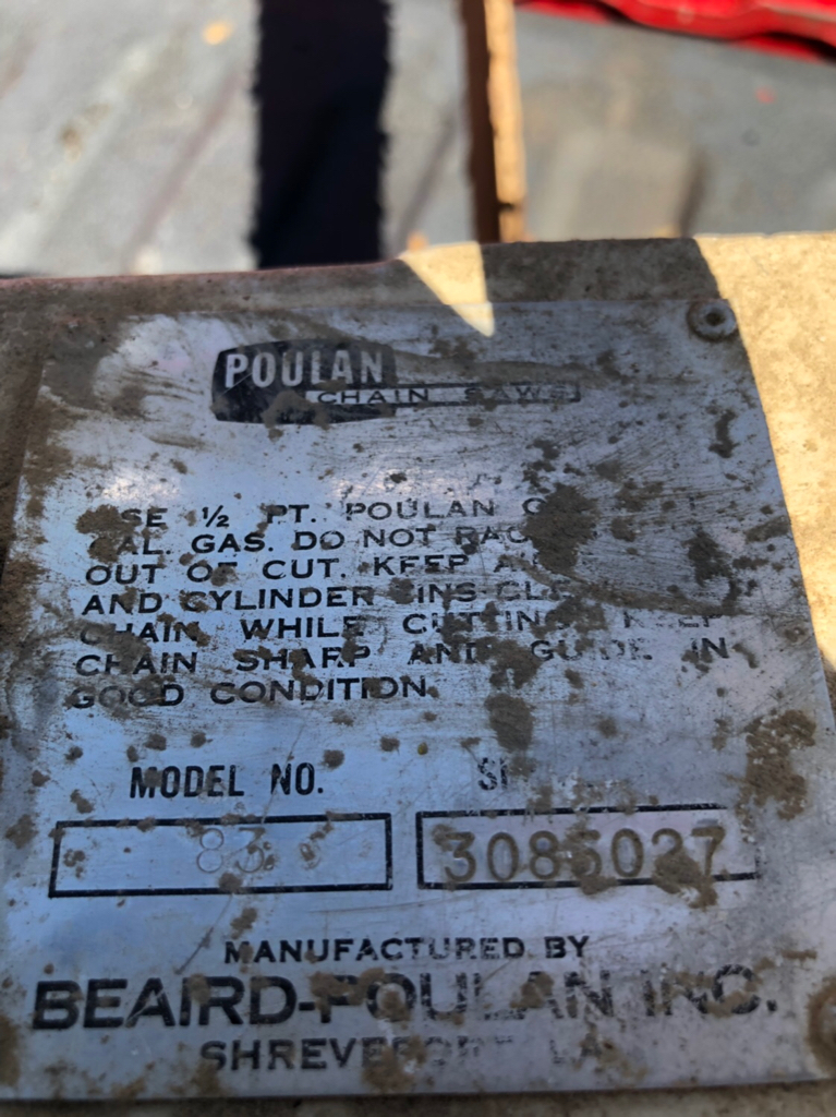

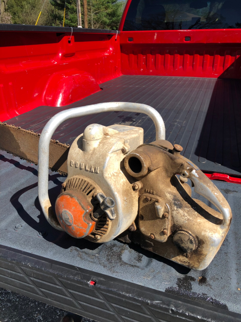

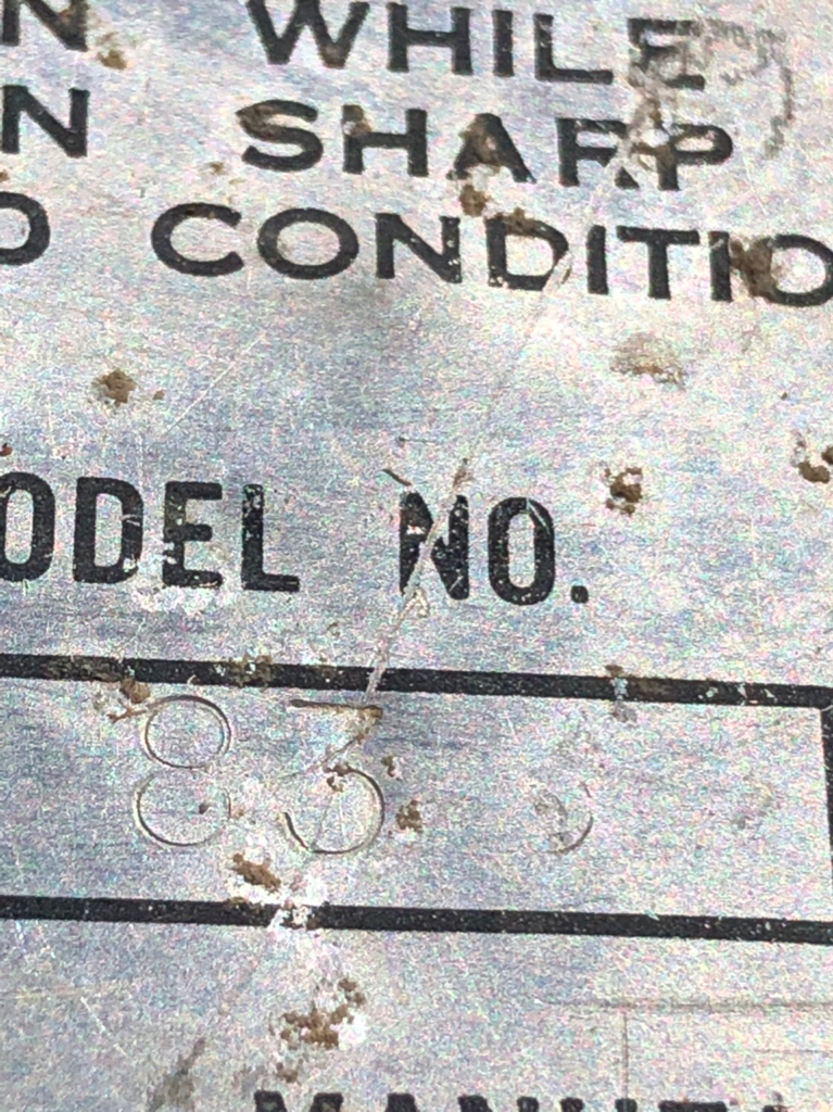

Anybody heard of a Poulan 83?
I can’t find anything on it!

Yup, I have an 85 & 91 which came after, they did skip around a bit also. The even numbers are gear drive. 83 84 85 86 91 92 etc. 65 66 super 66, 67 68 super , 71 71A & 72 etc

Need another for the collection?
