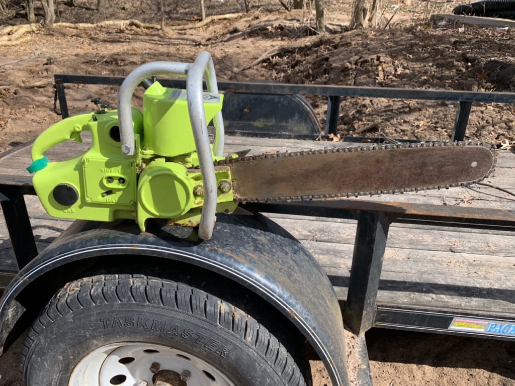

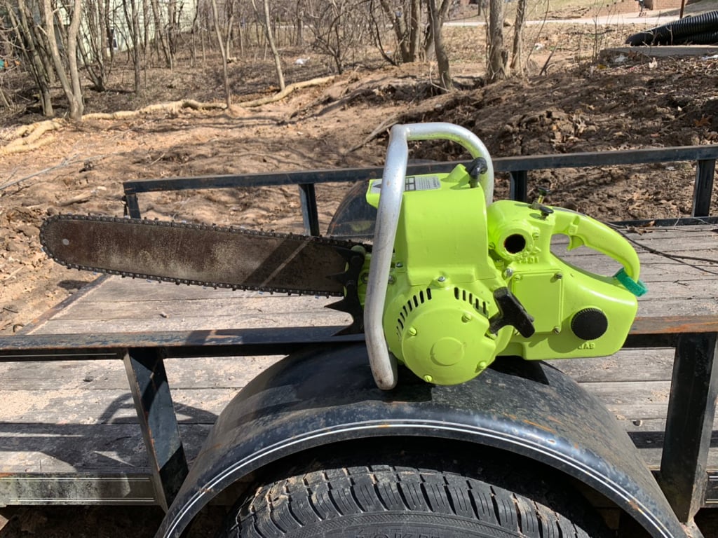

I got my latest Poulan project going finally. It’s a Model 53, and old enough as to where they had no cares about how much noise it generates. It started today on first pull and cuts decently. Carb kit, file the points, and a paint job got it cutting.

Too pretty to cut with.
