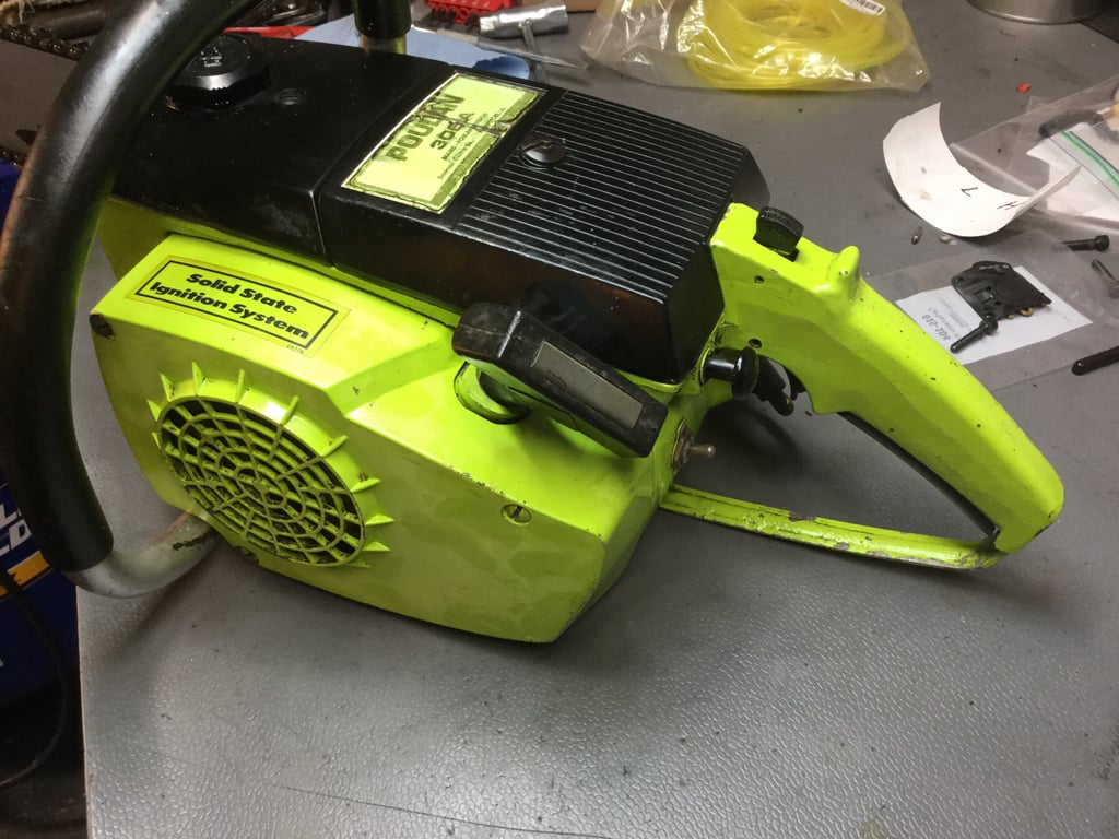

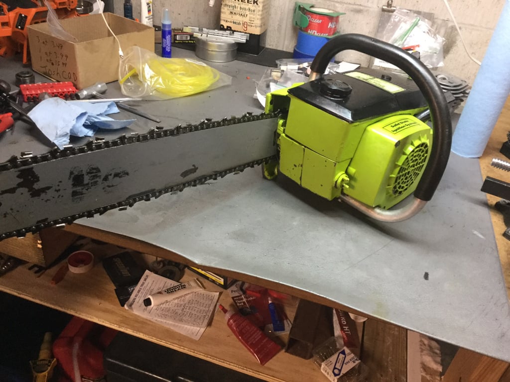

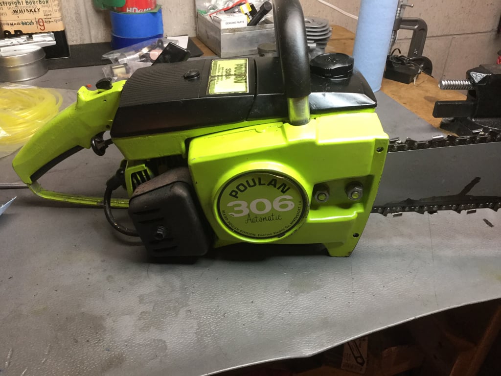

This is the 1st poulan I’ve had in my hands.
I can’t seem to find much info other than leatherface.
Is this model desirable?
Whadda you say OPE?
A co worker inherited it and I’ve just cleaned it up.
Really really clean under the filth.
Needs a carb to reed gasket and a new duck bill for the gas cap but runs.
Running and clean like this, what do you guys think this is worth?

Wow, almost like new. Looks to be in pretty good shape, congrats to him. If it was his father or grandfather, there is no price for memories.

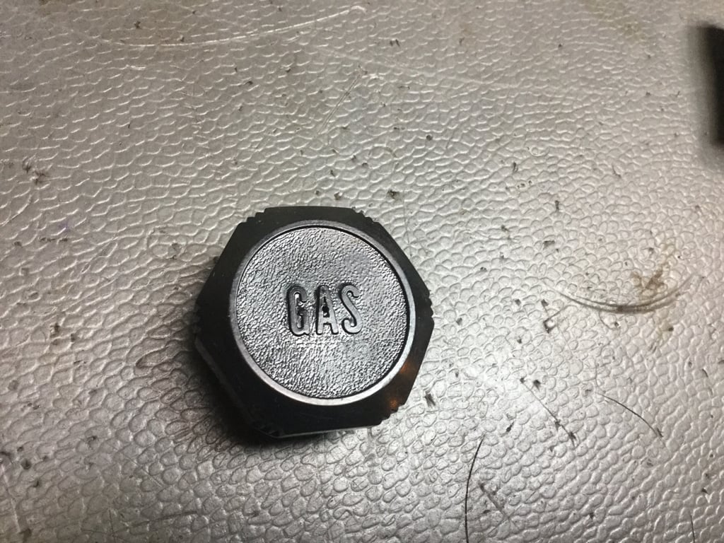

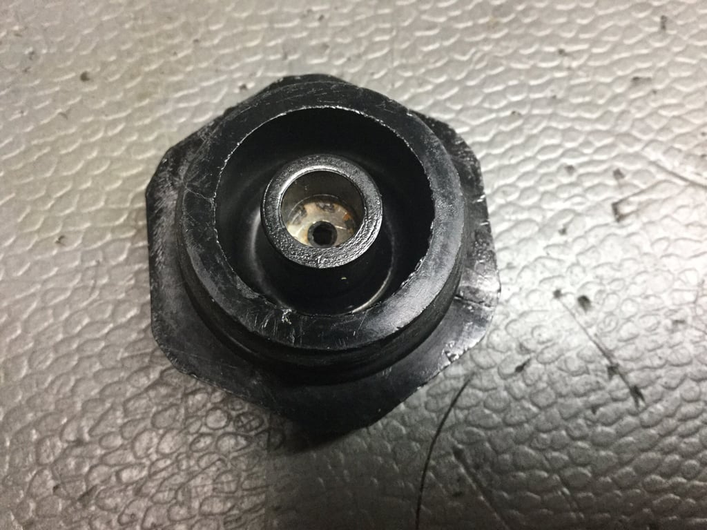

Say, would anyone know what check/duck bill valve this 306a cap takes?

Just guessing but looks like a standard Poulan green duck valve.
Steve, Samsung On5 using Tapatalk
Thank you sir.
Much appreciated.
Would you happen to know a good supplier for this?
