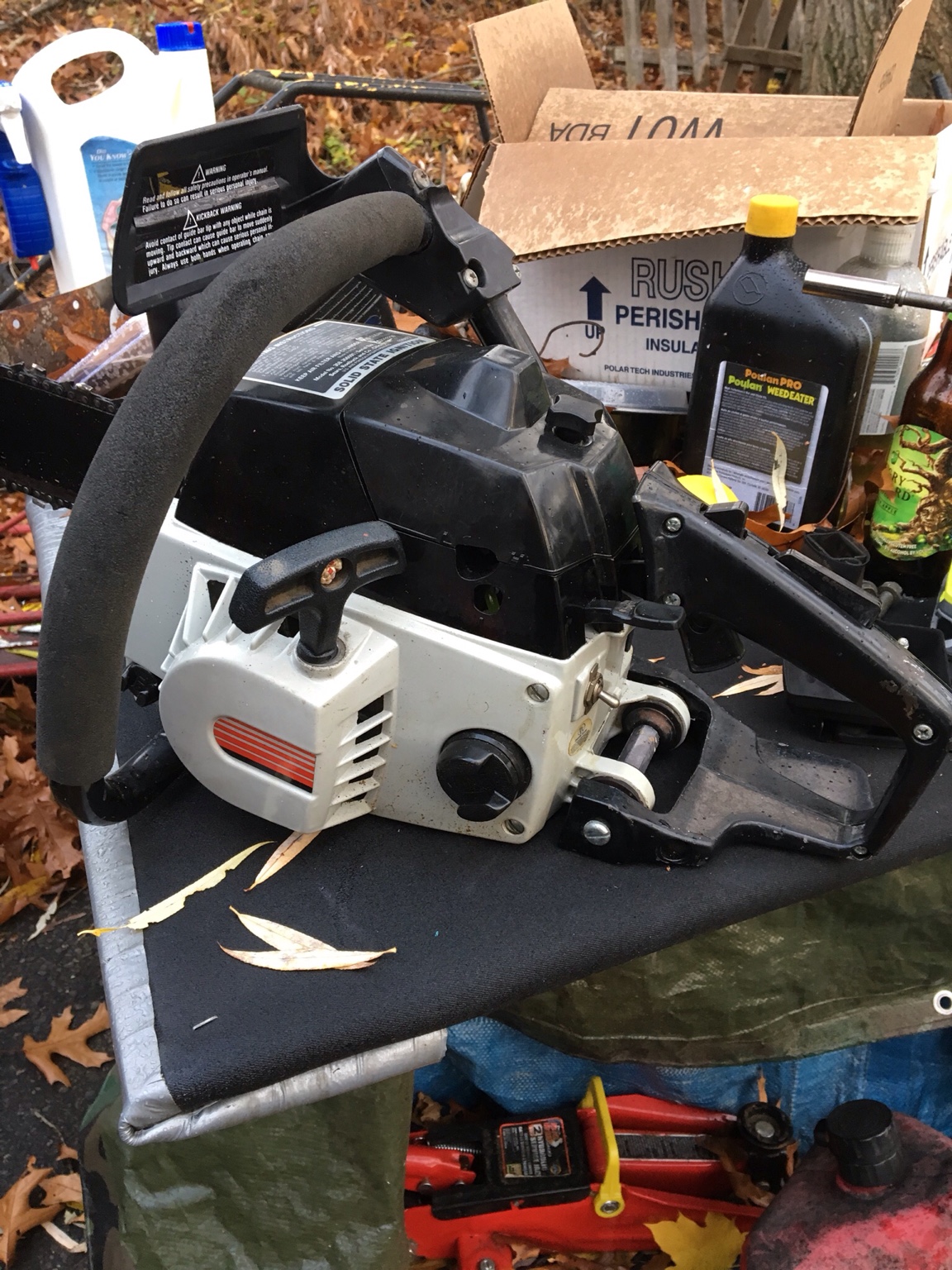

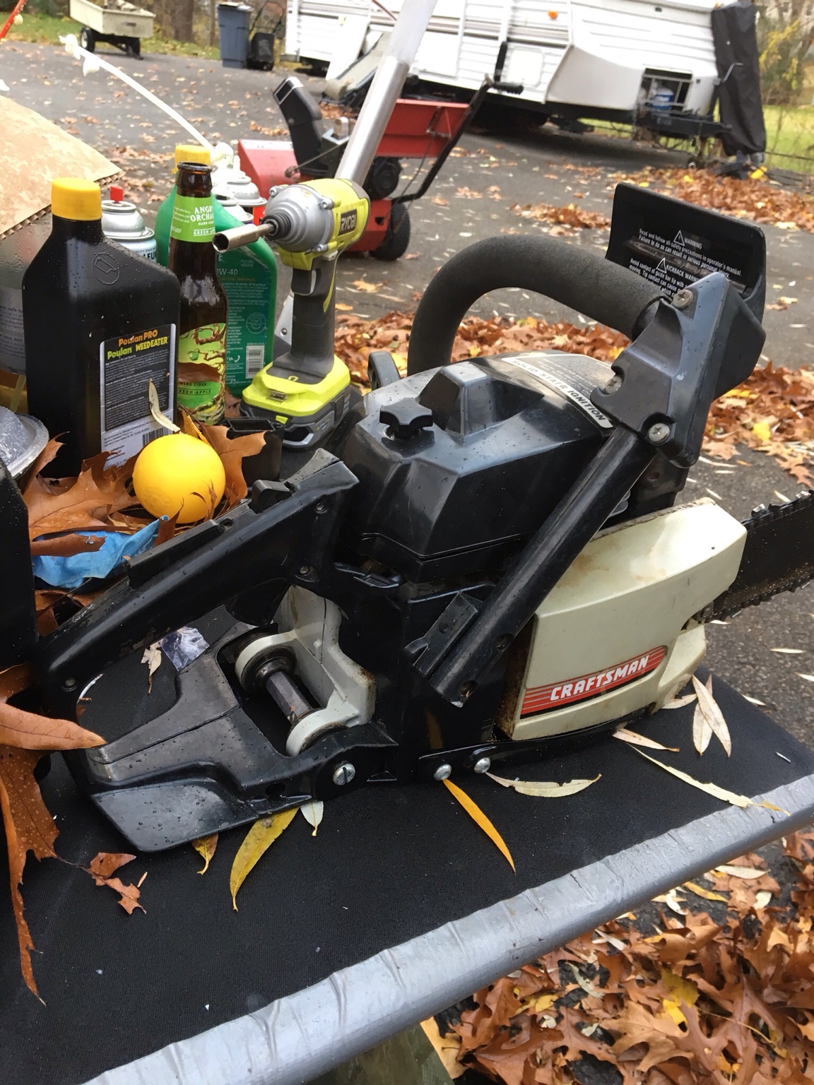

found a local $50 beauty

Very nice! 3400 or 3800?

I was told grey was 3400 only... if not I need to get model number. Would be sweet if it's another 3.7

Looks to be low hours, sweet deal.

Have a look and see if there is a 358.XXXXX number somewhere on the stickers.
Failing that, put a popsicle stick or plastic straw through the exhaust port to the back of the cylinder and bring the piston up with enough force to mark the stick or straw. Measure from the mark to the end of the stick / straw.
1.81" = 3400
1.88" = 3800
Very nice example no mater what it is. Congrats!

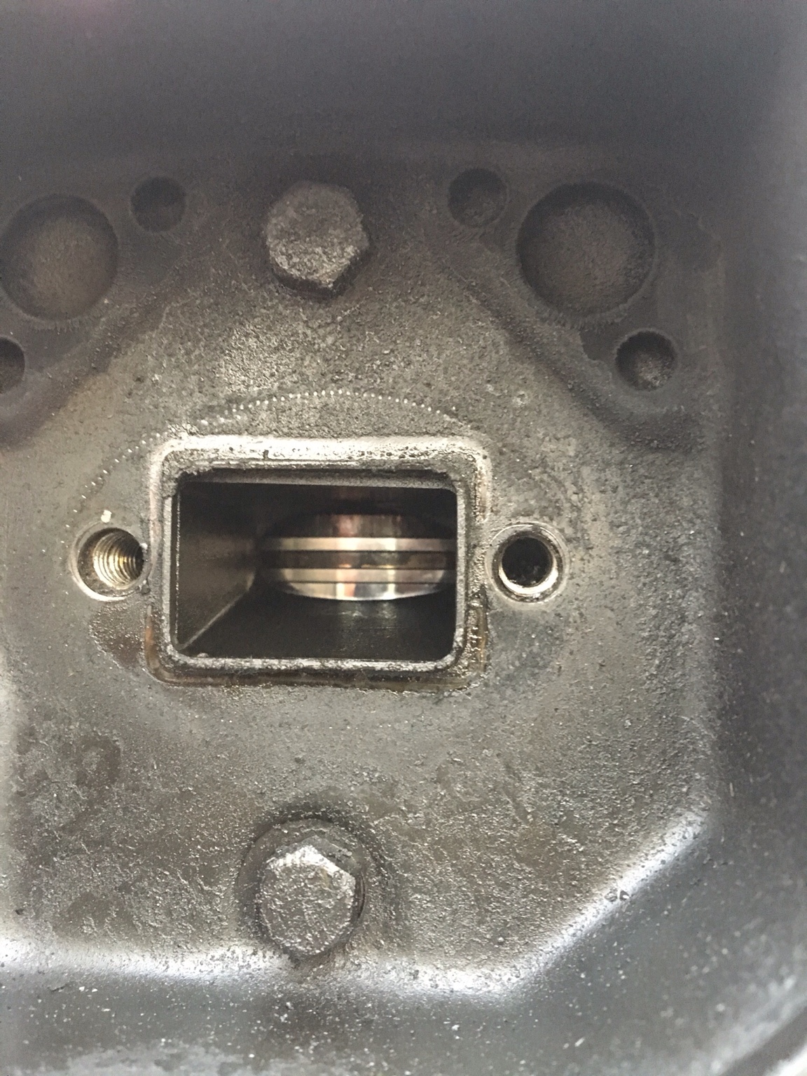

It's a 3.7[emoji1303][emoji1303]
It looks to be a 3800. The 3400 and 3800 have thick rings, chrome piston, aluminum bore. The 3700 and 4000 have thin rings, aluminum piston, chrome bore.
