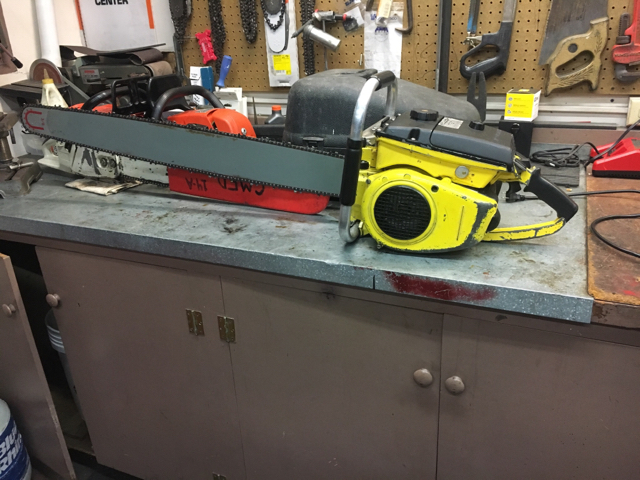

The SP70 is hurt as I thought. The piston shows scars toward the muffler. Unbolted the carb and set it askew to see the intake skirt at bdc. The skirt is nice but at bdc it shows a fresh shiny scar just under the rings. It needs be torn down.
Everything is dry. Straight gassed is my bet. The plug is dry but was run before and had good color with no transfer. The jug looks good through the spark plug hole. The muffler is all dried out.
I'll check the carb setting to see if it was leaned out and over-revved but doubtful.
Quote from the seller. "It ran two years ago."
That was half a sentence. The rest is, "until I straight gassed it and smoked the motor."

Fuel is straight, no oil. Just tested it.
Are these chrome or Fe liners?
I think it is a 1976-7
Saw model numbers is 600443E
Serial 11- 10630
That’s a bummer!!

That sucks.
Not really. I'm happy to get a complete saw missing one screw. Found one spot missing in the chip screen. New Ebay 35 bucks.
This just, just opened the door to mods :)
So, does the 81, 850 or other fit in my chassis?
Remember I'm McCULLOCH ignorant but not stupid.
The juice needs to be worth the squeeze. It's all or nothing. Not building a BB that lacks in carb, intake and exhaust just to have a BB. That would be stupid.
