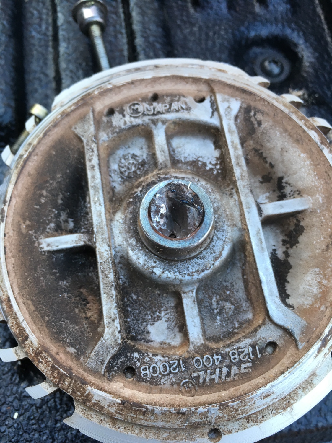

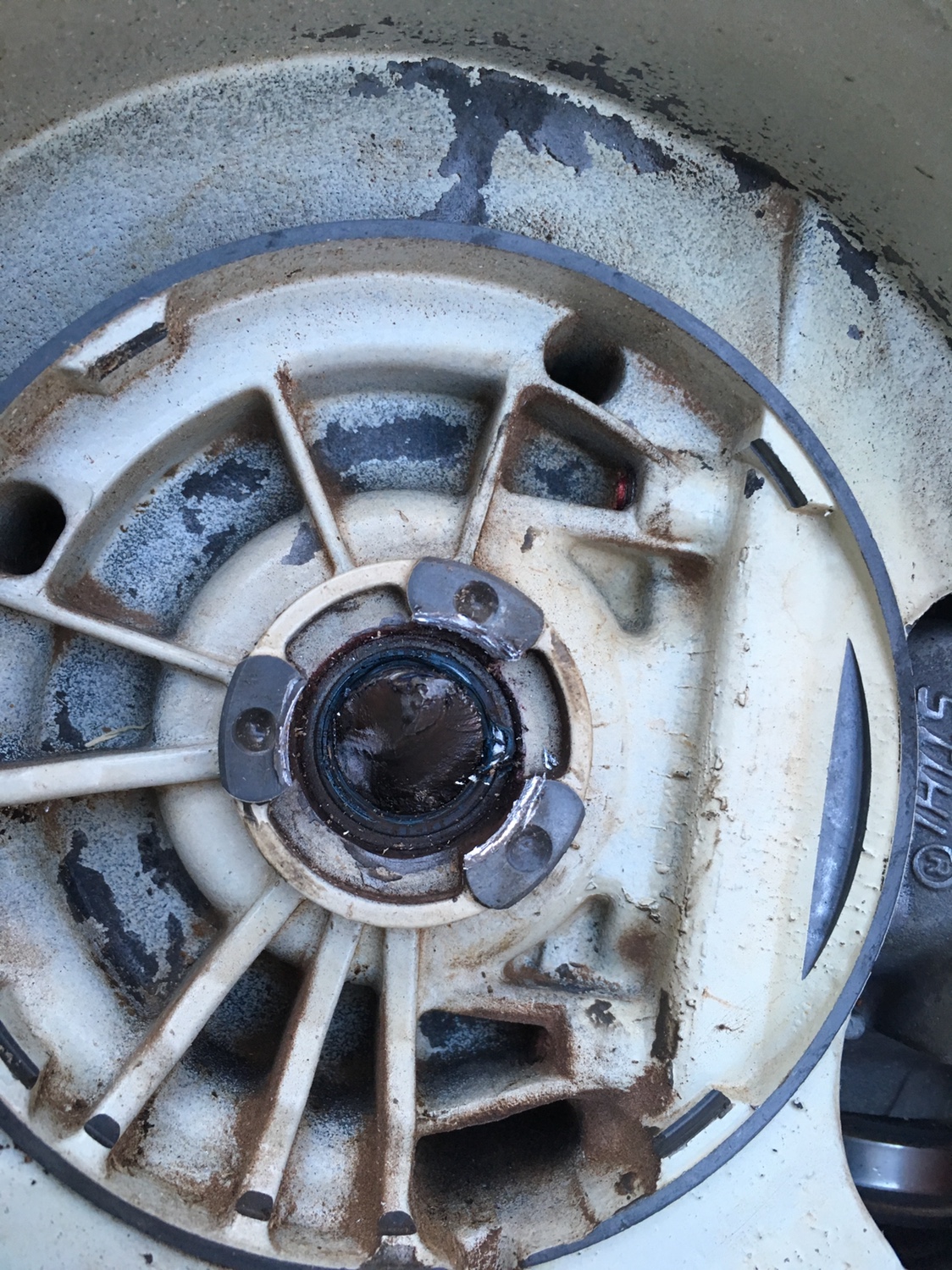

Haven't had a good kilt crankshaft in a while. Think this one qualifies ;-)View attachment 157761View attachment 157762
Oil line is playing peek-a-boo. Lol. I assume there was a casting flaw in the piston. Some how the AM cylinder survived. Kinda ...View attachment 157764 Owner of the tree service was present when I tore it down. Luckily he had a complete 066 case with an OEM top end that has a scored piston. Looks like the OEM cylinder will clean up from the donor
Wrist pin bearing might've chookashit. The middle section of the broken rod is blue on top

She's blue alright. Someone else has been in this saw. No signs of excessive heat this go round. Spark plug and muffler looked normal. Good mix in the tank. Maybe from the first meltdown? It did have a cheap China top end kit on it. No chatter like wear in the bore. Dunno

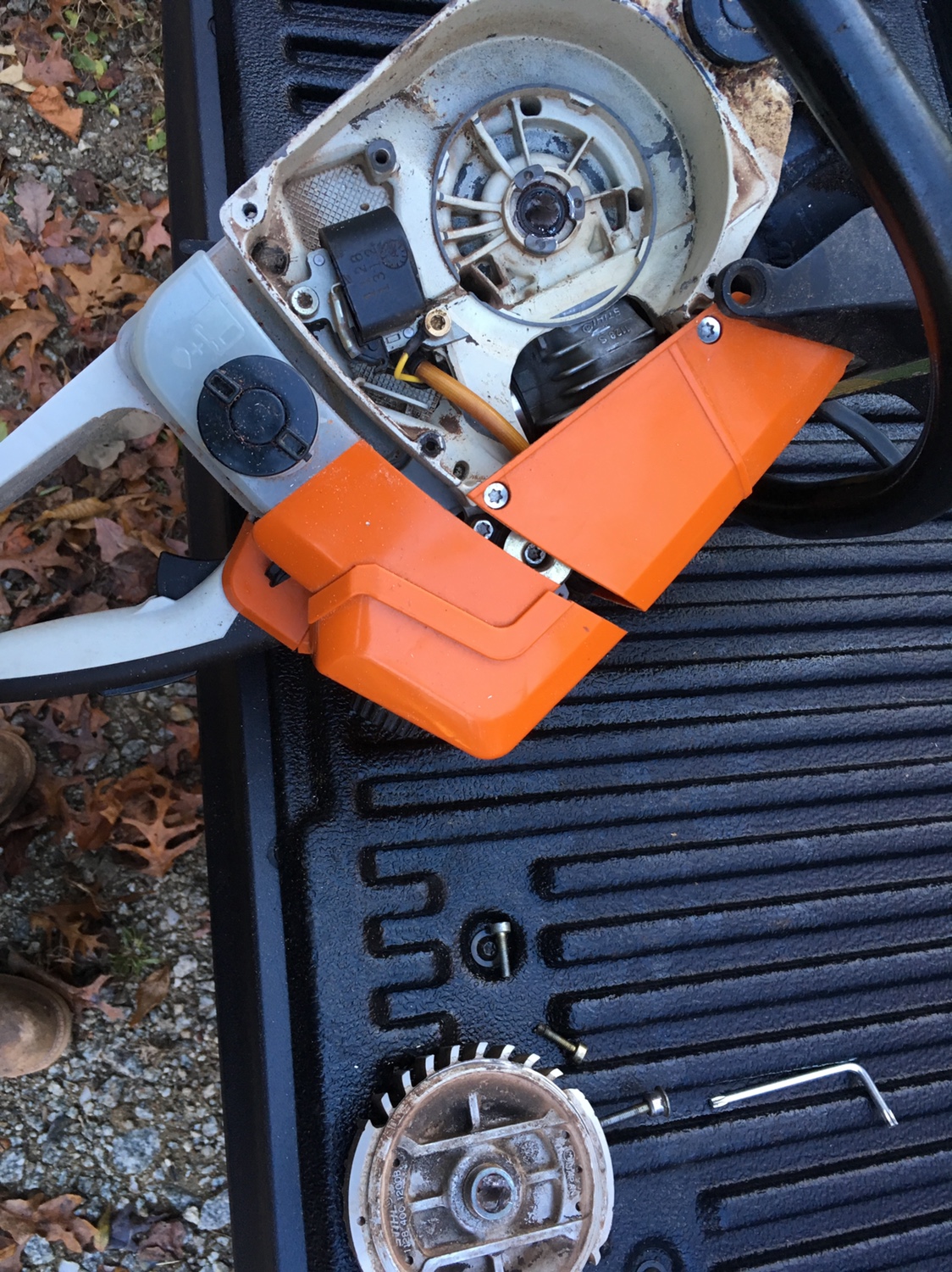

A nice Built saw from various donors.
Pro Tip,
It’s imperative that the crank taper perfectly match the flywheel taper. I truly didn’t realize how important.
No One’s fault & lesson learned, but the next time I think the timing is changing on a saw while it is running, I may or may not shut it down immediately.

Why did taper not match?
All appears to be 1128.
And..... should have used red armor.
