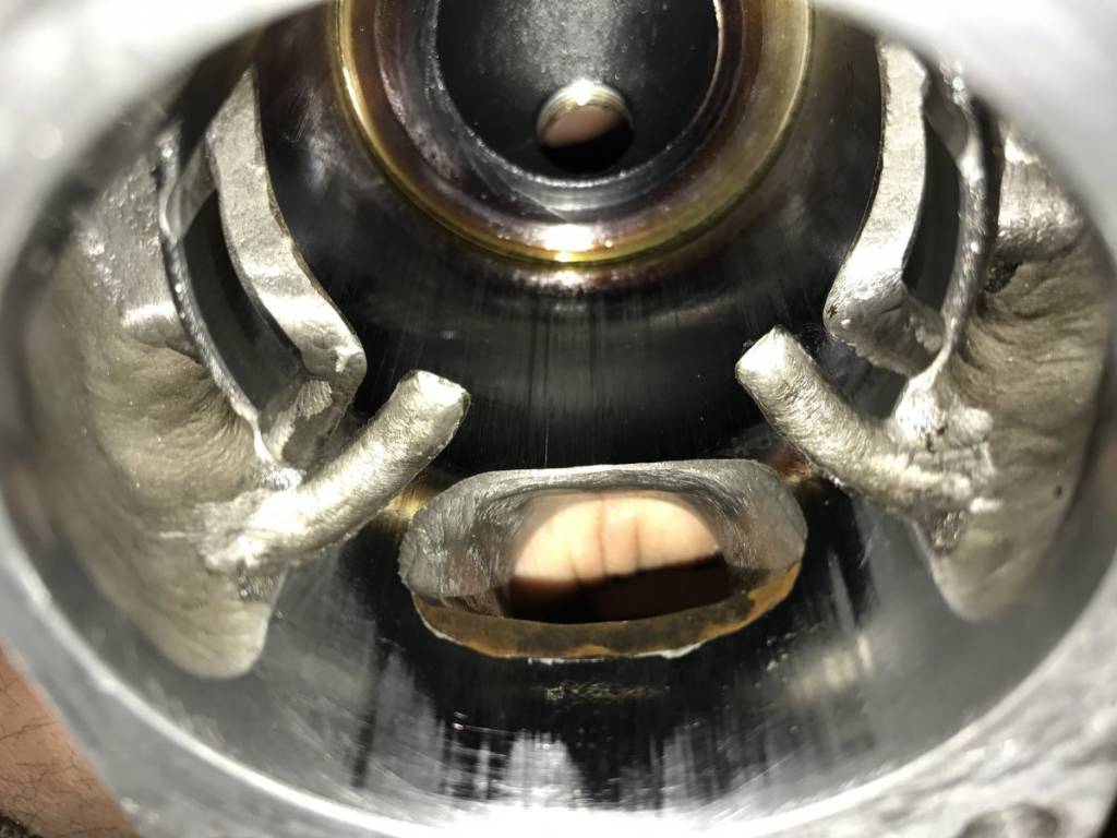

@Deets066
What were your thoughts on adding the cylinder wall side transfer grooves? Added volume, reduced velocity or trying to change direction of transfer flow more upward into the cylinder? I've never seen that before.
Not the finger ports.

Someone was looking at my pictures.....
@Deets066
LOL
I did get the bridges from you, but after a few cocktails... and ya grind bridges on the exhaust side..... Lol.:facepalm:
Fingers were added later, notice how they look better than all the rest of the grinding

@Deets066
Sent from my SM-S767VL using Tapatalk
More fuel above the rings.
More transfer, more better
