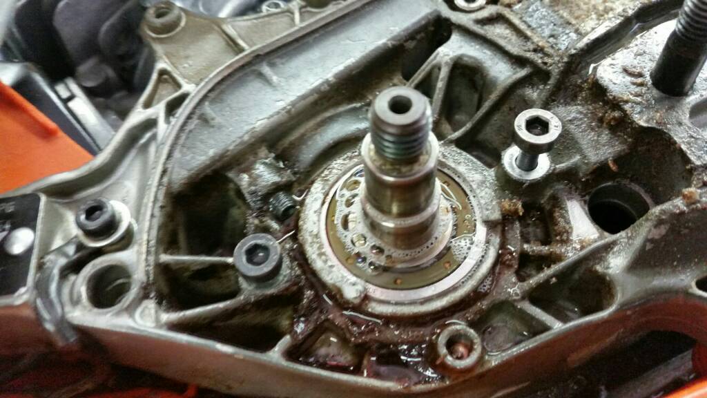

Can you install new seals without splitting the case? Or are they part of the bearing?

@Tor R
Yup, you sure can Brian.
The first years of 550 they used same bearing as 346 had, later v2 came and then v3, but I belive the seals are the same
