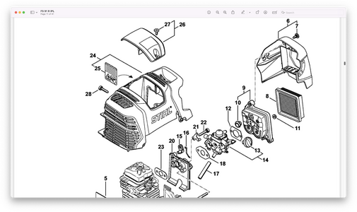

Merkava_4 Well-Known OPE Member Local time 3:30 PM User ID 6626 Joined Jul 7, 2018 Messages 169 Reaction score 137 Location Clovis, California Apr 23, 2026 #1 That blows my mind! They take the same air filter cover and clutch fan housing too! All this time I was thinking the FS131R powerhead was going be way. . .WAY BIGGER! This should make going from an FS91R to an FS131R a piece of cake!

E EFSM Pinnacle OPE Member Local time 5:30 PM User ID 29079 Joined Apr 30, 2024 Messages 1,577 Reaction score 3,886 Location Extreme southern IL Apr 23, 2026 #2 Merkava_4 said: All this time I was thinking the FS131R powerhead was going be way. . .WAY BIGGER! Click to expand... Nope. 90, 100, 110, 130 the same block series. 91, 111, 131 the same. They even use the same carburetor for all the different sizes in each series.

Merkava_4 Well-Known OPE Member Local time 3:30 PM User ID 6626 Joined Jul 7, 2018 Messages 169 Reaction score 137 Location Clovis, California Saturday at 1:02 PM #3 It even takes the same fuel tank. Last edited: Saturday at 3:01 PM
