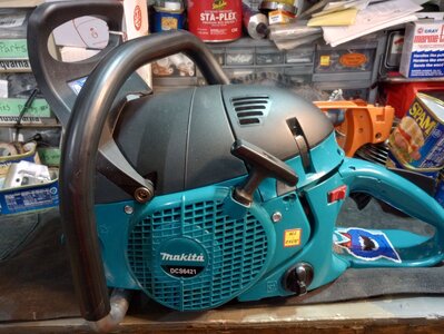

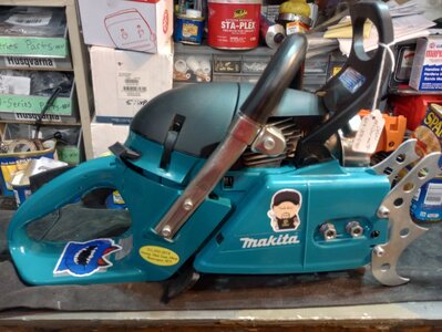

Might possibly have here the World's last ported 79cc Makita, as good/new saws are getting harder and harder to find. This one being a converted from a 6421. It was tuned to near 13,000 rpm and was four stroking in light cuts yet, so a tad fat for break in will be fine for now. Once it started two stroking in the cut the chain sounded like angry bees when it kicked in. Pretty happy with the initial performance and named it The Evil Cookie Monster for our good friend @Woodrow

I am sure I will be very happy with this version of the famous Captain Blueberry. I have a couple things to do to it now that it has been molested by @Stump Shot. A Euro Dolmar/Makita spike set, and probably a painted to match the Makita blue top cover and air filter cover. I will be looking for another winter air filter so I don't have to swap with one of the other Dolmar/Solo combos that I have. Thanks for the great work as always Steve!
You're most certainly welcome. Not sure if there will ever be another saw run just like Captain Blueberry exactly, but it's still a goodun, none the less! Odds are slim of me seeing another one, to have another go at it anyways. #worldslastported

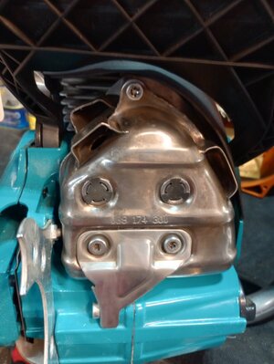

The 592xp is getting downright popular lately, and rightly so, heck of a saw all the way round. Starts easy and stays running without choke-out, cuts great and is easy on the hands with no vibes to bother you. Its takeover of the 90cc class is near complete and is not looking back.
This one is fully woods ported and will be logging full time. Muffler is modded with a screened @tree monkey large deflector.
