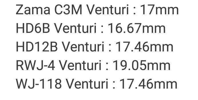

Good information, but it is a bit simplistic. Some carbs work better on a certain size displacement because of the carb configuration. The bigger venturi sounds good, but may not allow the carb to have the necessary fuel curves to get the best fuel delivery through the powerband - and that is the primary function of a good carb.
Brewz and I ran into that using a 460 carb on the modded 029 (64cc). That carb had a bigger venturi than the stock HD-5, but it didn't have the fuel curves the engine wanted. It appears that the 460 carb worked well on a 76cc saw, but just couldn't provide the necessary fuel curves on a 64cc engine. Perhaps it may be a good carb to consider modding for a 7900.
EDIT: The 460 carb also has a main discharge nozzle that doesn't stick out into the venturi to restrict the flow. I comes in at an angle and stays close to the edge of the venturi. The low pressure response through the nozzle, I expect, is much different than other carbs in it's class. Not only is the air flow through the venturi increased, but the fuel response to air flow is different. It could be the carb to mod for the bigger engines around 76cc+. I don't know, never done it...
