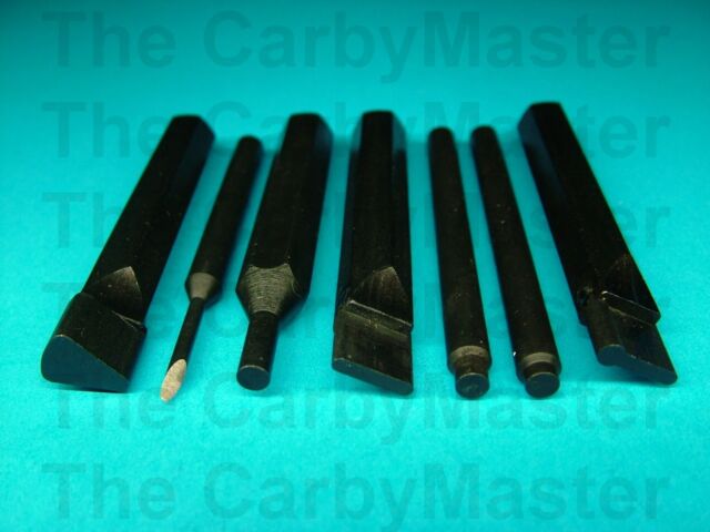

Welch plugs are normally dome until you install them by flattening the dome area. Zama actually have a set punches for doing this as they are size to fit the different welch plugs but they are a little expensive for anyone doing one time repairs so using an appropriate size punch making several punches to flatten the welch is an option.
I know Zama recommend sealing them but most I have installed are tight fitting and no sealant was needed.
PN ZTK101 for tool kit part number reference.

Great picture, I am sure I can fabricate one to fit, I do rebuild motorcycle race engines so I have a pretty decently equipped shop.
Again my friend I am in your debt. This has certainly been an experience of "pay forward"
