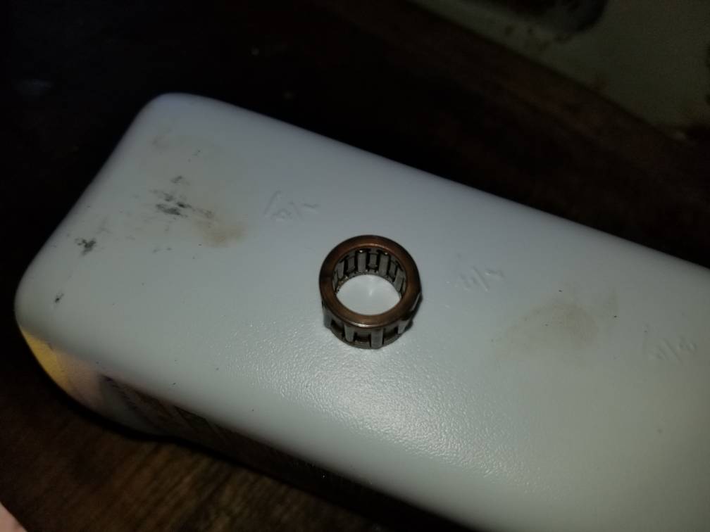

I swapped out the wrist pin bearing. That appears to be the problem. The saw is alot smoother now. Thank you everyone for the suggestions. I still need to check the clutch.

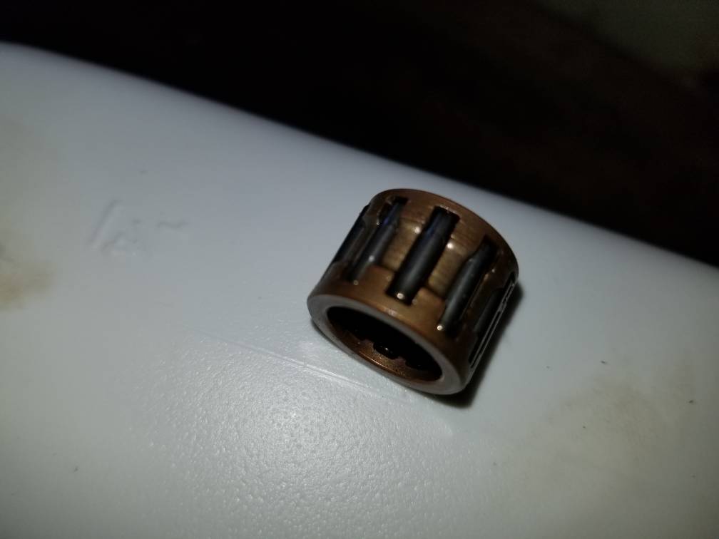

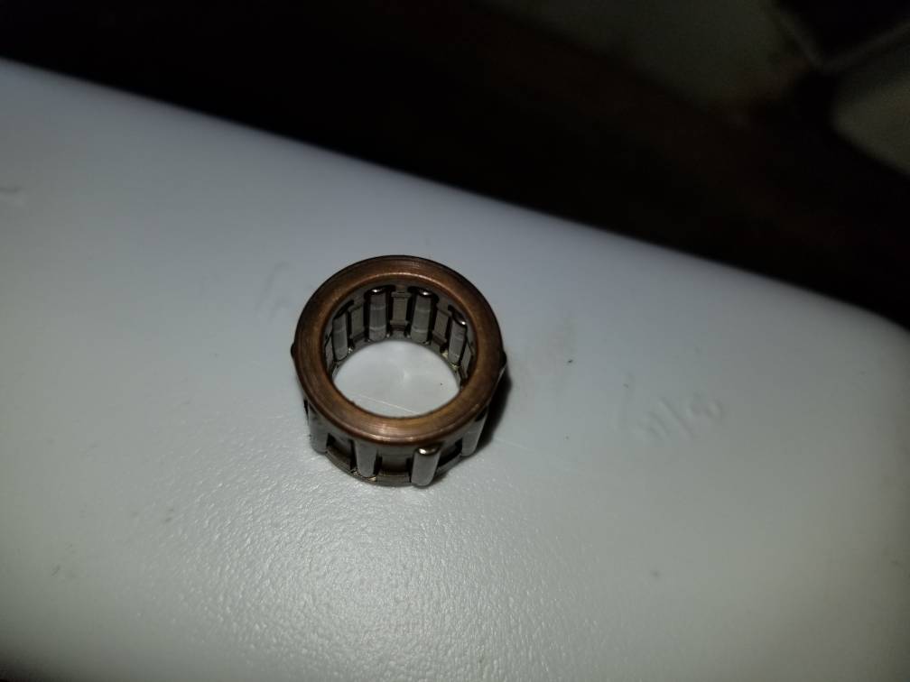

Here is the wrist pin bearing I took out.

Often AM pistons and pins are heavier than OEM, and will result in increased vibration, ditto all Big Bore Kits.
Also, if your AM piston pin begins to fail, you will also notice increased vibration. Don't ask how I know, but for $10 I now use OEM wrist pin bearings.
Luckily, I felt it, and tore it down before damage was done.
