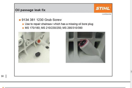

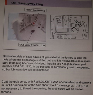

Hi there, I am in the process of seeing if I can acquire a Stihl ms230 because it's leaking chain oil from the front of the tank between the inside where the bar fits exhaust side and the exhaust, there is a vent or plug missing. The saw is no longer useable but is there a vent I can buy to sort it or another way to solve the leaking problem.

There should be a little orange or reddish plug that caps that oil passage on the bar side of the muffler . I don’t remember if Stihl offers a replacement plug, but I thread a short set screw with loctite in the hole. I’ve never had one come out, but you must take care not to thread it in too deep, or it obstructs the oil flow.

Thanks for that I shall make enquiries if not then a screw will be fitted.

A 1/4 x 3/8 set screw from the hardware store can be substituted, but since it is larger in diameter you should tap the hole first to prevent cracking the plastic case.
