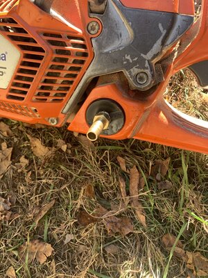

even though i have fixed some of them. i usually dump them so i dont have a big mess

With no air bubble in the tanks there is no air to expand nor retract due to temperature changes!
Just saying.
And if so, just running the saw would create leaks. Oil/Tank temps climb higher and faster with use then outside temps.

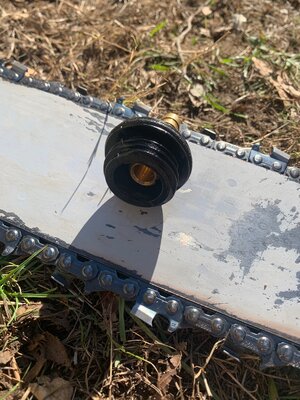

I've found mine will leak like crazy in the summer but quit right about now. Maybe the temperature drop thickens the oil? I also started filling the tank all the way full when done cutting and that really seemed to help.
