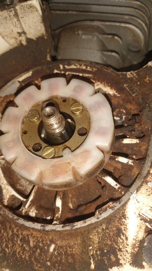

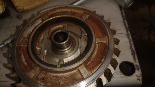

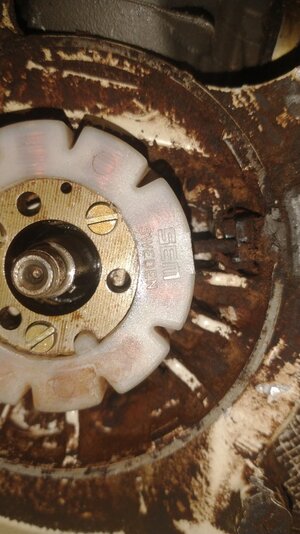

not quite sure what Im looking for underneath the flywheel, but it doesnt appear to be any obvious damage to the coil underneath, or the inside of the flywheel.
going to change this back to an active for sale posting.

not quite sure what Im looking for underneath the flywheel, but it doesnt appear to be any obvious damage to the coil underneath, not the inside of the flywheel.
That looks good - the SEM piece is the generator for the heating elements in the carburetor and handles.
