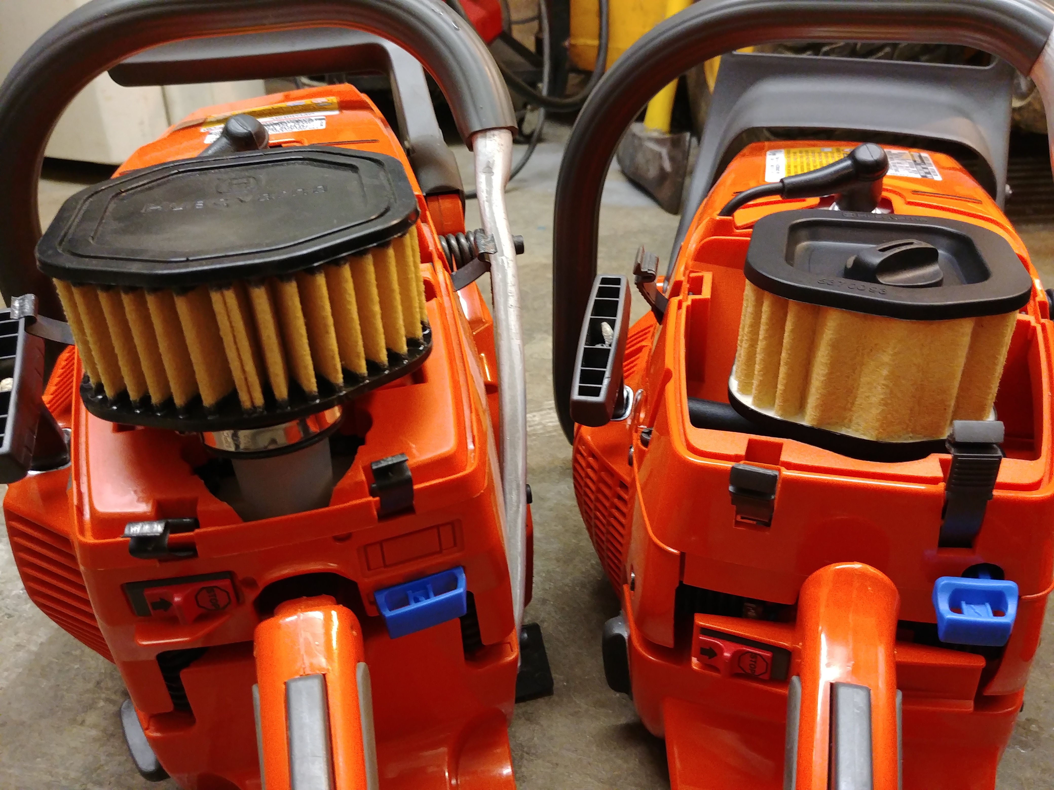

A lighter piston is pretty much always better, and Strato pistons tend to be quite a bit heavier than non Strato pistons, so this should help that. Although I never had any complaints with the first generation 362 I owned. Well the air filter was pretty horrendously design.

PS. Just looking out for you.
Don't ask for air filter pics!!!

Not what you were expecting is it.[emoji1]
