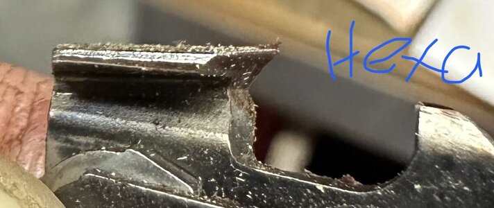

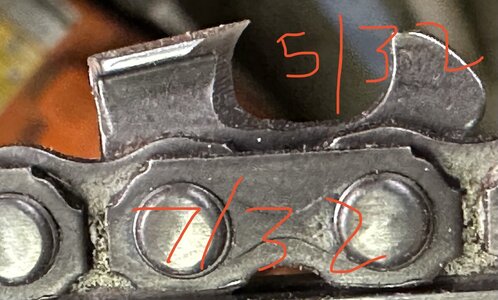

The red lines are the important angle. The balance between speed/self feed and durability. More vertical, more durable. Hexa is pretty vertical and flat and it seems durable in my testing. My latest fast recipe is a std grind or 7/32” file followed up by a few licks under the leading edge with a 5/32”. (Blue lines) Fast and slices tough desert pine better than a durable grind, but the edge rolls off quickly in dart hard dirty Eucalyptus that the hexa keeps cutting in.

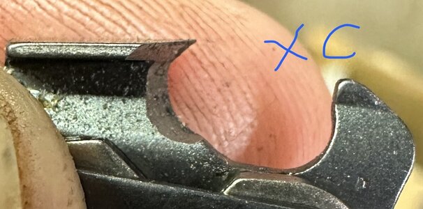

The chain I posted above is not a high flow or low drag chain. It is a regular old work chain with as-specified angles, but ground deeper to make a more durable edge.
If you want a fast chain...
#1 is sharp
#2 is chip flow
#3 is reduced drag
You can make a chain much more efficient, and that allows you to run it faster and take a bigger bite. You can do a lot to a work chain to make it faster without sacrificing durability. Square filed, with the shelf, directs chips straight under the cutter. Round can be made to flow the same way, but it takes longer to resharpen, so it's less convenient for a work chain. Dog-boned links hold chips and keep them out of the next cutter.
Look at how the chips would flow through the cutter on this chain. See how the shelf and open corner act like a funnel? The chips are directed right at the most open part of the tooth.

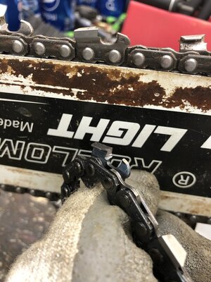

C90A1D01-2ABE-429D-85D4-257A7E4D6499.jpegThat shouldn’t cut too bad, out of the box square is dull you need to at least drop the rakers most of the time it needs ground.

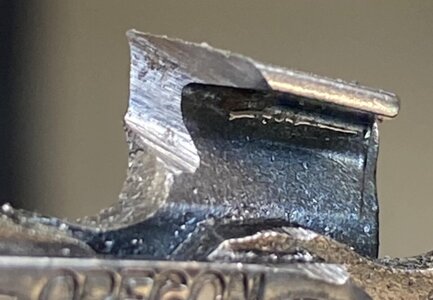

Outta the box chain isn’t even close to being sharp , compared to after grinding it in a square grinder , it actually cut pretty crappy outta the box .
Oregon especially. Stihl square cuts okay out of the box but Oregon has top beaks and a curved top plate, it feels dull, but after a grinding it’s as good as stihl and faster/smoother than round ground or filed.
