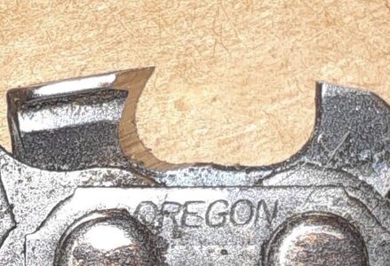

I wanted to try the hexa grind on 325 chain . I ordered a 1/8" wheel and profiled it . I used some Oregon 20 lpx 325 chain .

I got a chance to test it out at my cabin yesterday . I used my xs 550xp . I cut 40 cookies in popple and then 40 cookies in oak . I'm really liking this grind . It seems durable and pretty fast .

You are not supposed to make Your own "Hexa" out of a random non-Stihl sub 20$ chain and a profiled/dressed 10$ pink grinding wheel!
You are supposed to buy the original Stihl Hexa chain because it it a specially designed chain, and the original unique Stihl Hexa file - it will probably cost You only 50$ or more and be totally worth it!
Also, watch it - You might face copyright charges by making Your own "Hexa" the way Stihl doesn't want You too!
