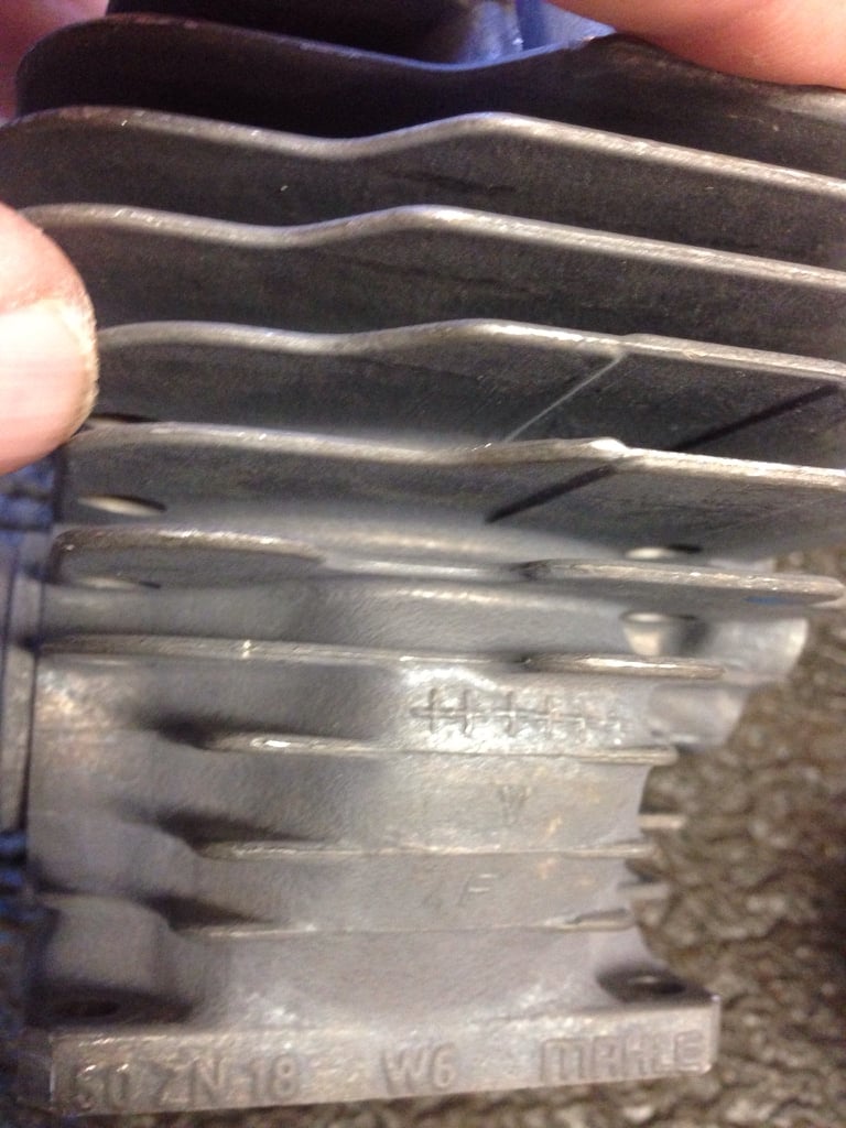

I'm talking about just the bare cylinders. Is there a way to tell the difference?
Casting numbers? Cooling fins?
I have never seen a ks on a 12mm saw ,those i would call 10mm jugs ,i would say mahle with 4 or so ++++ marks could be a 12mm jug

ive had a few of the slant fin stihl cylinders from 10mm saws the one i have here now is a 127 serial number i sent one to @T.Roller and one to @huskihl kevin
Yep. The one I got from you was a mahle 10mm slant non decomp.

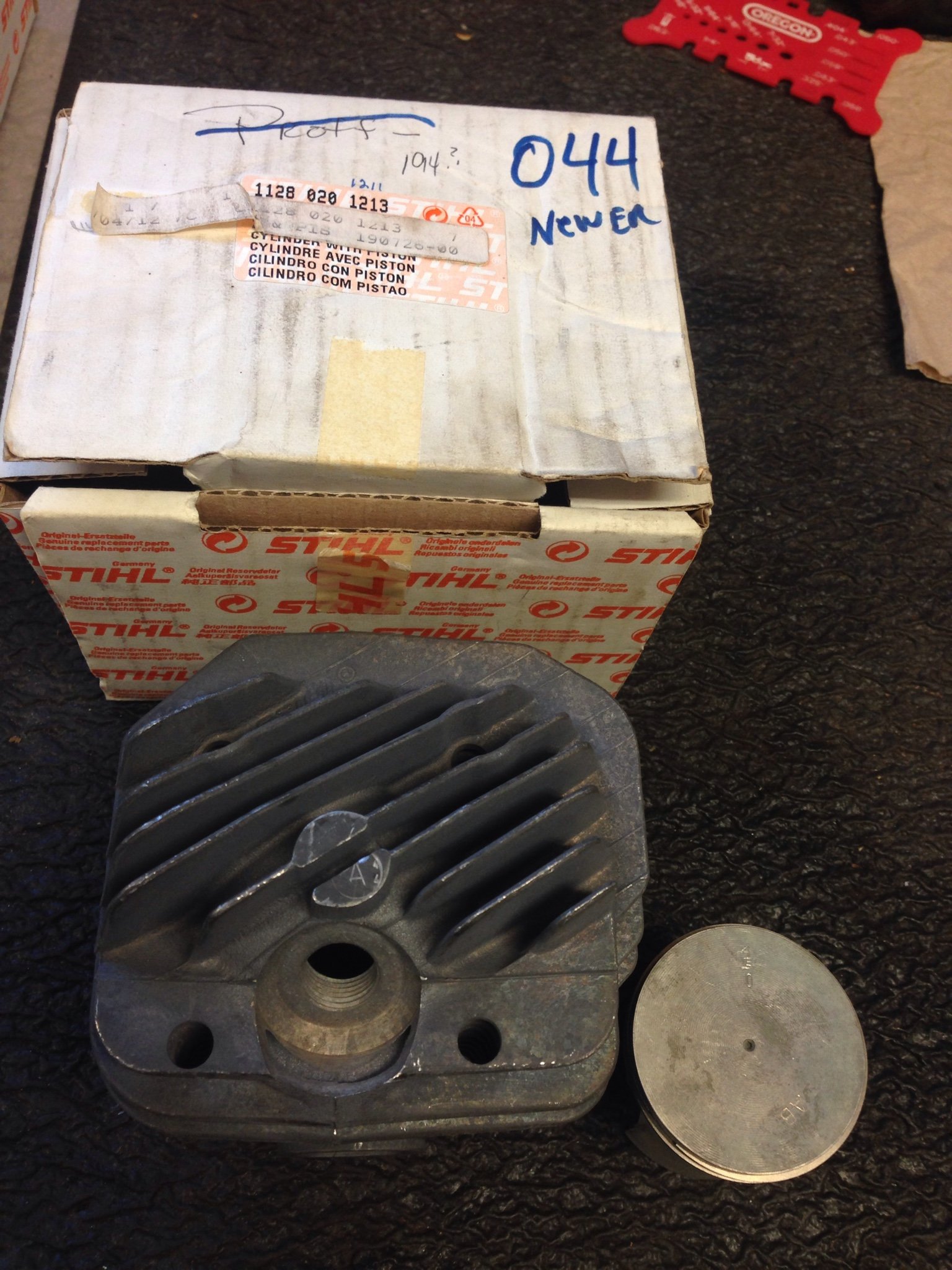

Handy this came up. Chatting with Ted, big t double about an nos piston and cylinder I have for an 044. May be sending it down the road. Has a 12mm piston but looks like the oe 10mm I have here has the pins in the same place.
