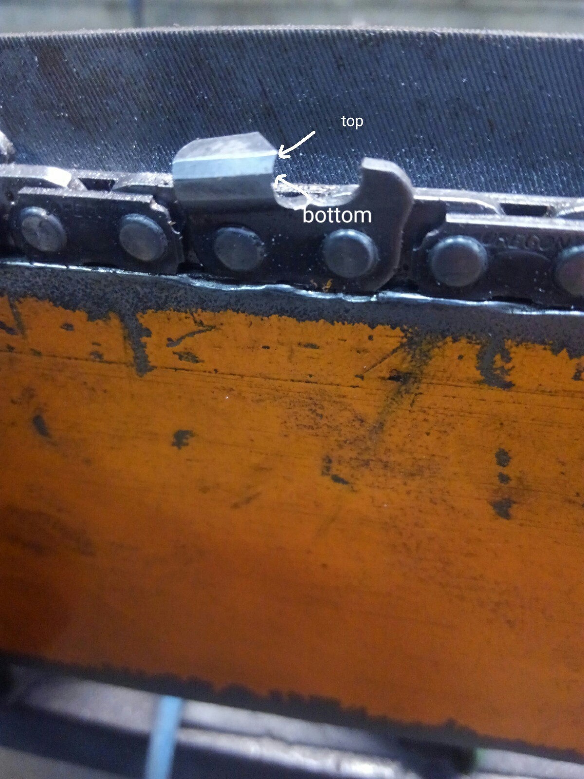

I had another look at this chain I got.. no prizes as to where it’s from. I took it out the packet for closer inspection today.. after writing what I did above..
This chain is a semi chisel and I thought it had a sq grind on it. So can someone tell me what sort of grind it has on it from the factory o_O
For ref.. it’s a 16” 325 chain
View attachment 278967 View attachment 278968 View attachment 278971
I don’t have the chains at hand but that cutter side profile looks exactly like some semi chisel Archer I bought a couple years back. I commented on how unusual it was and wondered what the grinding wheel would look like and I believe @Philbert commented on how many of the newer aggressive grinds were accomplished on CNC machines using multiple passes at different angles
I kind of think @RI Chevy had some with that same funky sideways chevron grind

Those look like micro chisel like the 19hx is.
I had to look up 19HX
I honestly can’t find a good enough picture to get a comparison
I have seen pictures of other Chinese chains with similar side profiles in the various threads when someone discovers a new brand of chain
Just looking at it from the side I agree it has a very linear geometric profile that might make you think it’s some weird square variant
Both of these are 19hx
3browns
2:52 PM
7617
Oct 18, 2018
5,117
40,536
Fishhook, Alaska
:nusenuse::nusenuse:
So it’s harvester chain, right?
Is it considered full chisel or semi chisel or what
Looks like flat top plate, flat side plate, and a 45 degree angle jointing them instead of a 90 or a curve

its intresting you say the chain I took pics off looks similar to an archer. the chain was from hutzl aka farmatec
iirc I ordered the same as I did before. then those guys sent me those chains, which were different to the first lot.
ive no idea which one are the correct chains to the part number I ordered.
although I'm sure one of the types was a husky chain [1.5mm] instead of the 1.6mm that I ordered.
I will go back through my orders and see if I can make anything from it.
edit. I just looked at the chain and it looks like a micro semi chisel ( its small and rounded, no sq edges), is that a rapid super in the stihl range

Yes it’s harvester they call it micro chisel.

RM in Stihl terminology I think if it's semi chisel
