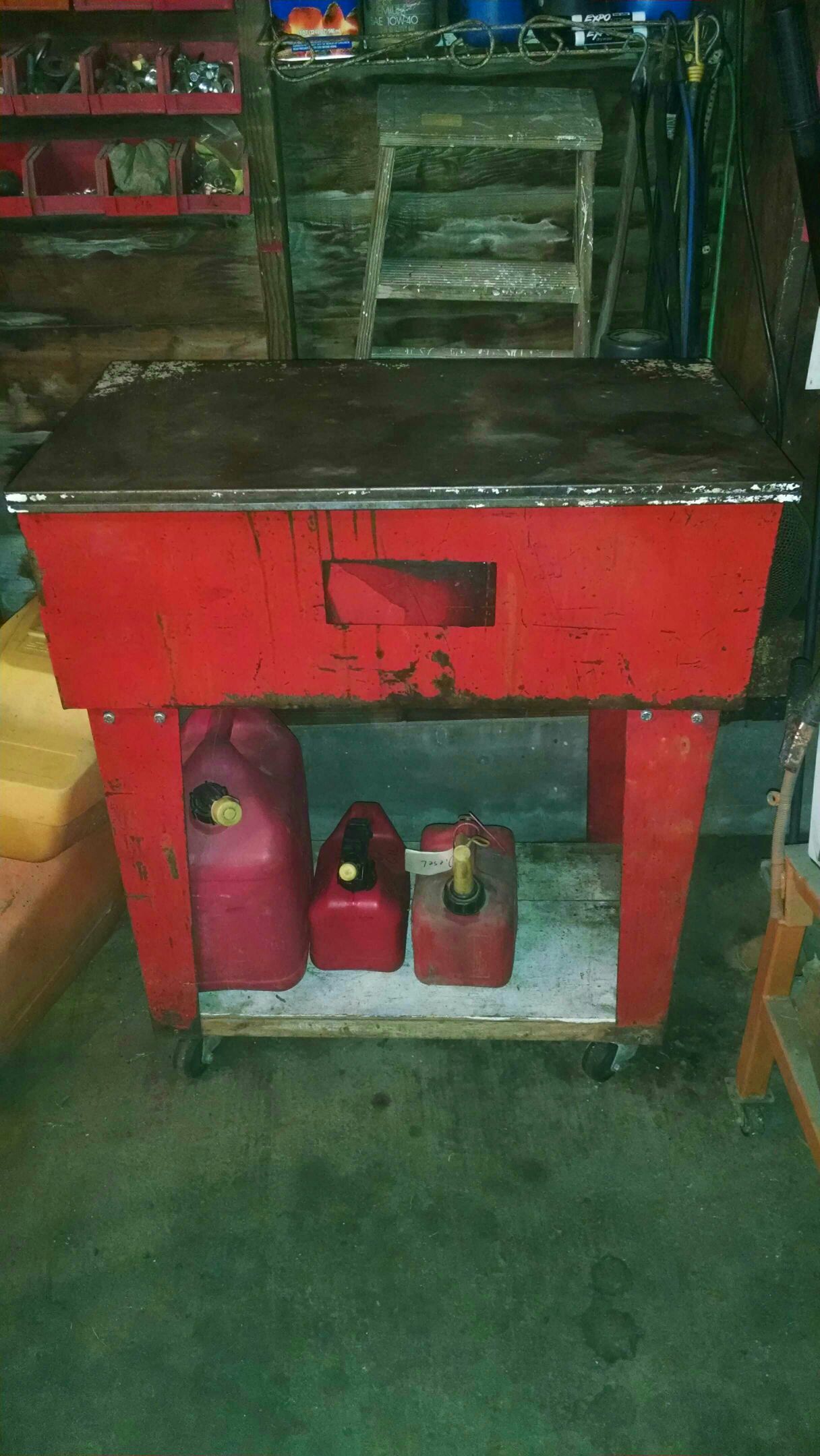

I bought one (20 gallon on wheels) from Tractor Supply along with 10 gallons of their PSC1000 cleaner (naptha) which they claimed would work. It did....for a week then all the orings swelled to the point that the plastic pump fittings broke. They claimed they had never seen that before so they gave me a pump from another shelf unit. Same thing.
I ended up replacing the aquarium pump they use with a pump that is designed for parts washers and solvents (Little Giant 1YS) which I got used on ebay. I've used it over a year and it works great. I've added a flow-thru brush, a valve to control flow rate and a filtration system. I had to do some minor sheetmetal mods but overall it went smoothly. I probably have $200 into it without including the solvent (another $80).
