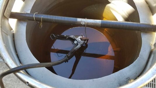

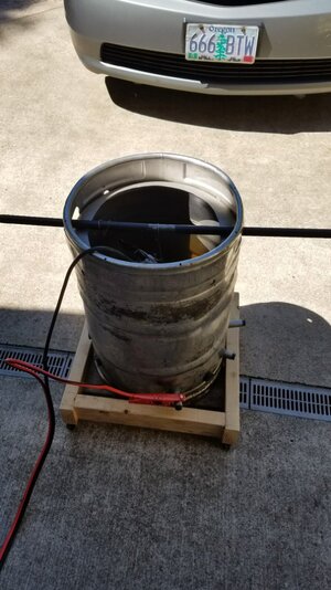

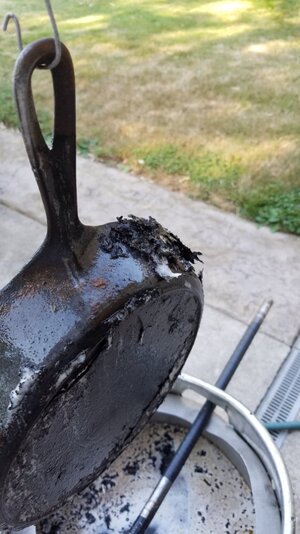

i made my tank out of a beer keg because i wanted a tank small enough that it was easy to move around. i made a base with wheels so i could roll it around when it has water in it. i dont have to mess with finding metal to put in it because the whole thing is stainless. i was just putting cast iron skillets in it.
