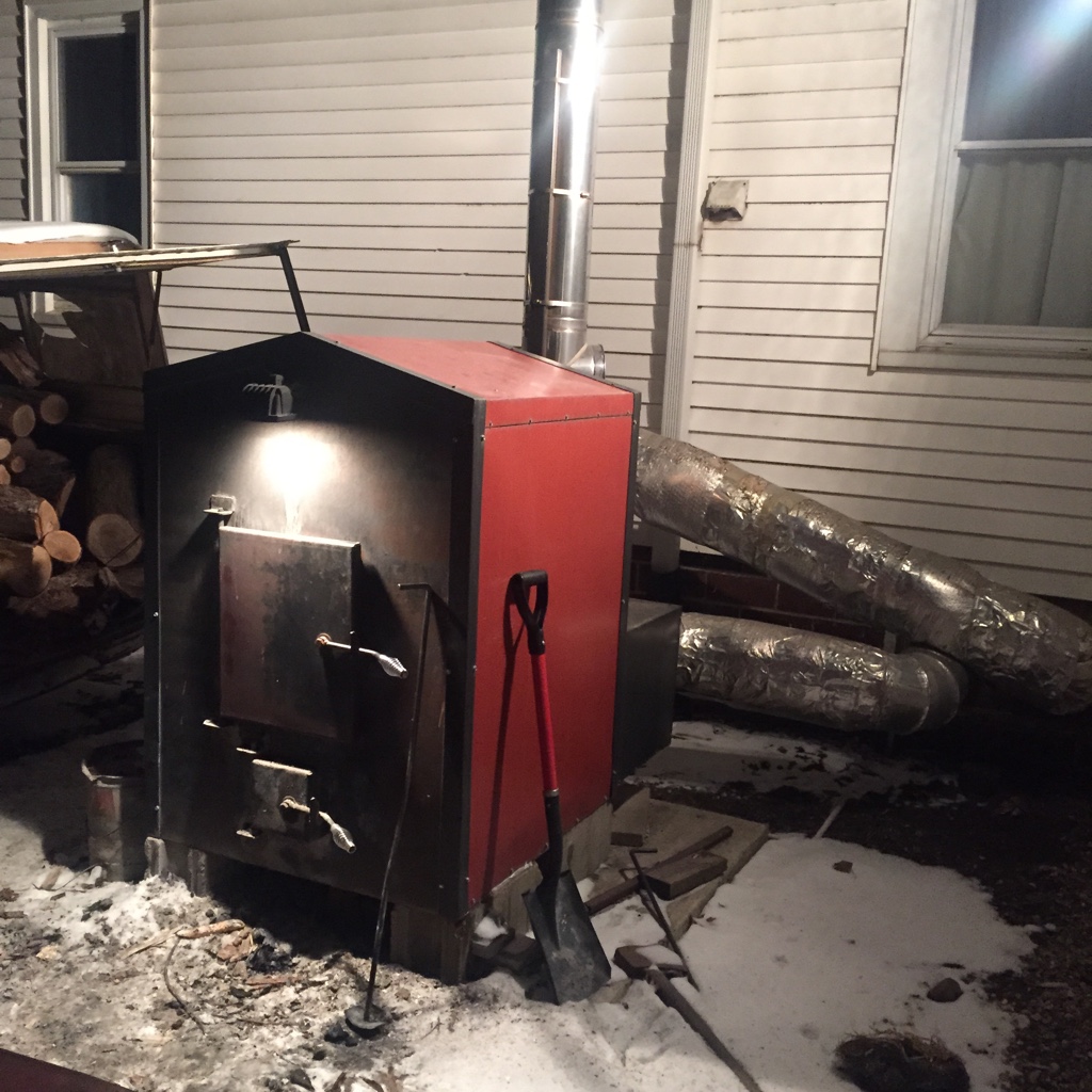

heres what I got, the boiler is at the farm heating Mom and Dads house along with 2 shops and outside forced air is what I heat my house with. Hope to have my boiler going for next winter

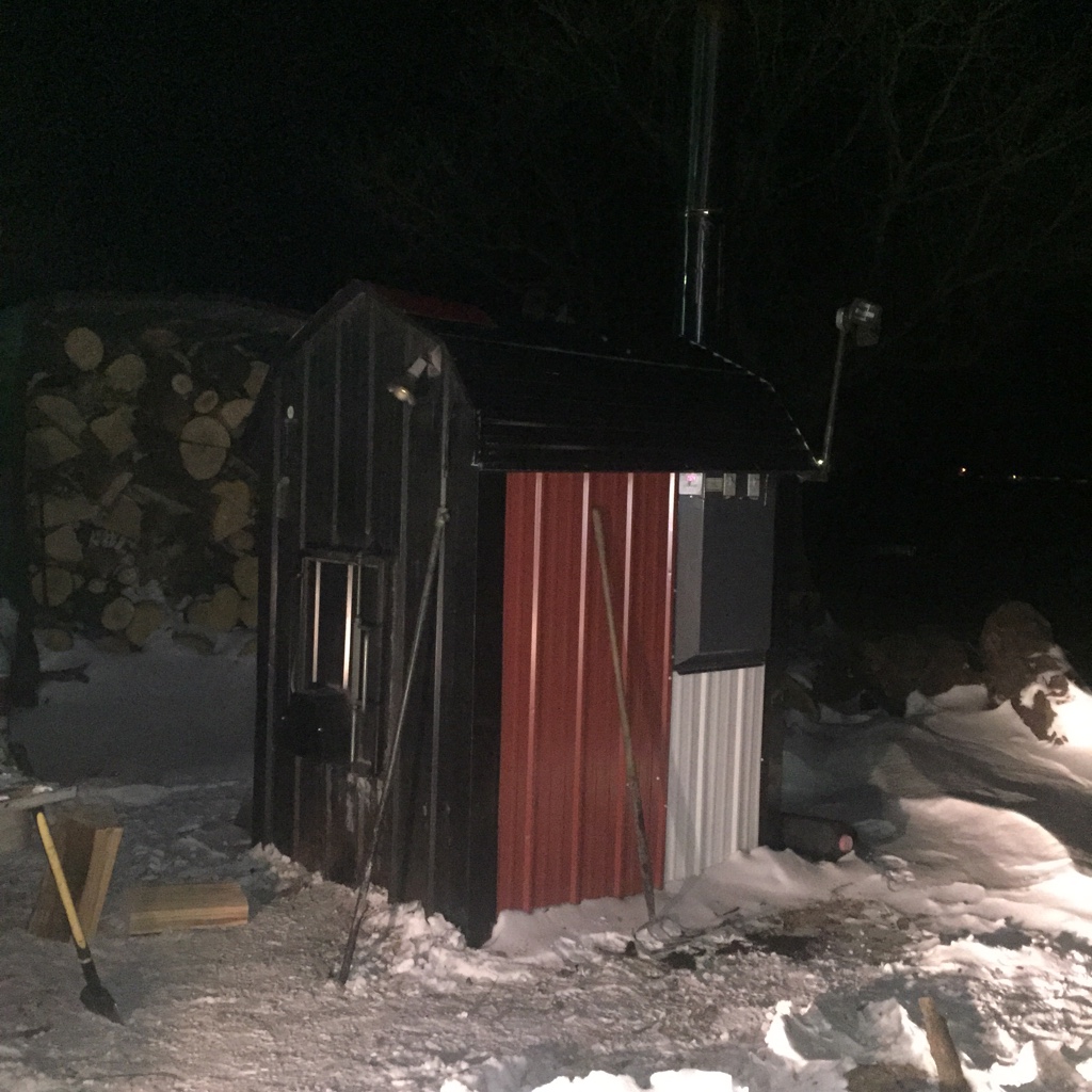

Fill it up once daily with anything that burns, been burning a mix of ash and unseasoned maple, cherry, poplar and hickory.
Need to start seasoning my wood stock better....burns more wood than the buck stove thats in the house but not having smoke/fire inside and not having to split the wood is worth it.

Interesting. Think the outside boiler is inherently less efficient than the woodstove, or is it your setup/unseasoned wood? I can definitely see the advantages of not having smoke/fire inside and not having to split wood.

One inefficiency, I believe, is the water jacket around the fire box. I think this leads to incomplete combustion, and more hydrocarbons go out before burning . Some correct me is that's not true.
And the second reason for more wood is, the whole house is 73~74*, and the buck stove only heated some rooms to 80* and let the others drop to as low as 65*.
And thirdly I think the 150' line set looses some heat to the ground.
This outdoor fireplace is suppose to be more efficient than some others because it has a tripple pass on the exhaust before the smoke exits the top.
