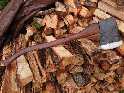

Here's my hang of the day - Keesteel 2kg Tasmanian on a hard curve hickory.
I boiled the head in black tea for an hour, to convert the red rust into a hardened black coating, which has a great look. The handle was darkened with a few coats of vinegar/steel wool to oxidize the wood. After looking at it all finished, I wish I had taken some wood off the shoulder of the handle, but overall I'm proud of this one.

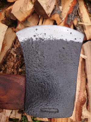

Today's fresh hang - A five pounder tasmanian on a 32" fawns foot. Flat grind with a microbevel.
Unsure of the maker, so if anyone has an idea, I'm all ears! It's a beauty though2025-11-21-14-54-56-810.jpg
Unsure of the maker, so if anyone has an idea, I'm all ears! It's a beauty thoughView attachment 475432
The blue paint looks the same as what's on a lot of vintage northern European axe heads.
Wetterlings?
eric4
8:09 PM
21775
Dec 23, 2021
233
526
Northern CA
Wetterlings?
I was able to find pics of a Wetterlings tasmanian, and the blue on my axe has a greener hue, but not as green as my Gransfors tasmanian. The pattern geometry also doesn't seem to match a wetterlings or gransfors
My best guess is Hults Bruk or Sater Banko if I'm going purely off paint color. The steel quality and patina definitely resemble sandvik/Swedish steel. Plus ya don't see too many 5 pounders. Most max out at 4.5
