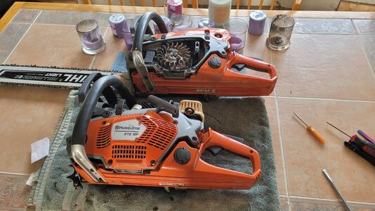

Have two 572s so im debating bumping upper transfer alittle wider and blending smoothing intake castings.
Will this make gains leaving timming alone or will i just be grinding for fun.
With the removable transfer covers i kinda think i have to do it. Its calling me.
Deleting gasket i think transfer covers and skirt extensions have to be clearanced slightly.
I also have a good running 461 but upper transfers are hard to get to. But do have a good oem cylinder for it. And its kinda a beater saw so i wont be to sad if my grinding makes negative gains.
I just cut fire wood with 28 and 32" bars most the time in 30" plus sized wood. The 461 is working well with 32" just muffler modded. Ive yet to cut with 572 in the real world.
Faster is always better.
Thanks guys

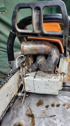

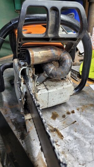

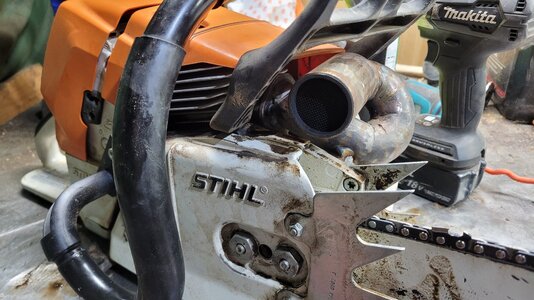

Evan03, Where's the outlet? Got any more views/angles of that little tucked in creation of curvatude?
The final(?) round canister portion got a stinger (perforated?) tube inside, any baffling or is it some sort of resonant chamber?...
Or if there's a link somewhere already, someone point me to it please?
I remember someone mention building a "suppressor" style baffled muffler for a saw.
I've pondered the same idea for a backpack blower, where the bit of extra weight probably wouldn't be as noticeable or in the way of usage.
edit: ahhh. (I need more sleep somehow) I see more pics of it over on the "show off your muffler mods" thread. Sort of puts me in mind of some of the pipes I've seen in the "long Tail boats" racing videos.

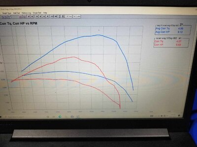

Interesting you like more exhaust duration. I did a 98 roof (100 stock) and it didn't have any grunt. I would have thought with a 39mm stroke a 98 would be enough.
On the next cylinder I used all the same numbers with a 103 roof and it pulls like a train.

NW Washington
Heres the 98 roof all else the same. Stock 572 with same 28 inch bar and chain was about 13-14 seconds.
