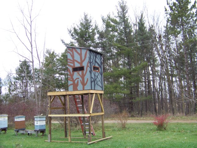

Pile of hive bodies and intercovers
Raised deer blinds.
