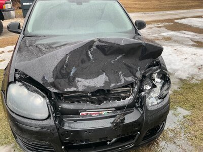

I’ve had this 2005 Jetta BRM 5 speed for 9 years and it ran great until a whitetail deer buggared up the front end last month. I bought it with 190,000 miles from a diesel mechanic and it’s currently at 298,000. This is/was my first car and has been one of the best cost to own vehicles I have had. 54 MPG in the summer mid to upper 40’s on winter blend. Okay on plowed snow covered roads with decent tires. Their traction control system works great. I am on the fence to fix this one or get a newer TDI.IMG_0100.jpeg

I’ve had this 2005 Jetta BRM 5 speed for 9 years and it ran great until a whitetail deer buggared up the front end last month. I bought it with 190,000 miles from a diesel mechanic and it’s currently at 298,000. This is/was my first car and has been one of the best cost to own vehicles I have had. 54 MPG in the summer mid to upper 40’s on winter blend. Okay on plowed snow covered roads with decent tires. Their traction control system works great. I am on the fence to fix this one or get a newer TDI.View attachment 483396
The Volkswagens I've owned were great cars despite the work I had to put into them. If a low-mile, grandma-owned version of a car like yours or a low mile MKIV VR6 comes up for sale in my area, I'm grabbing it.
I've been told to get a grandma owned one or something lower miles that's not already hood stacked. Probably a good idea.
