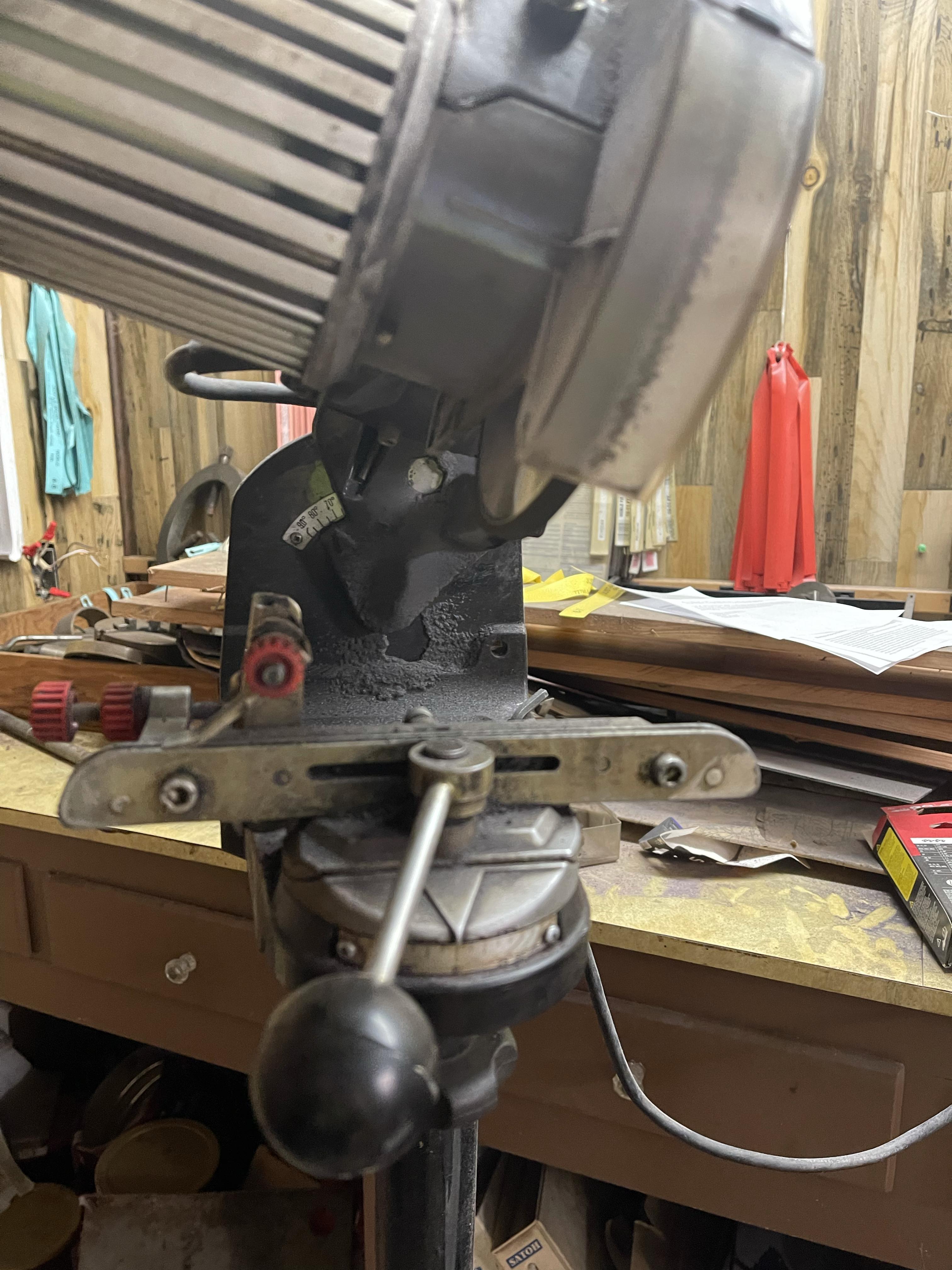

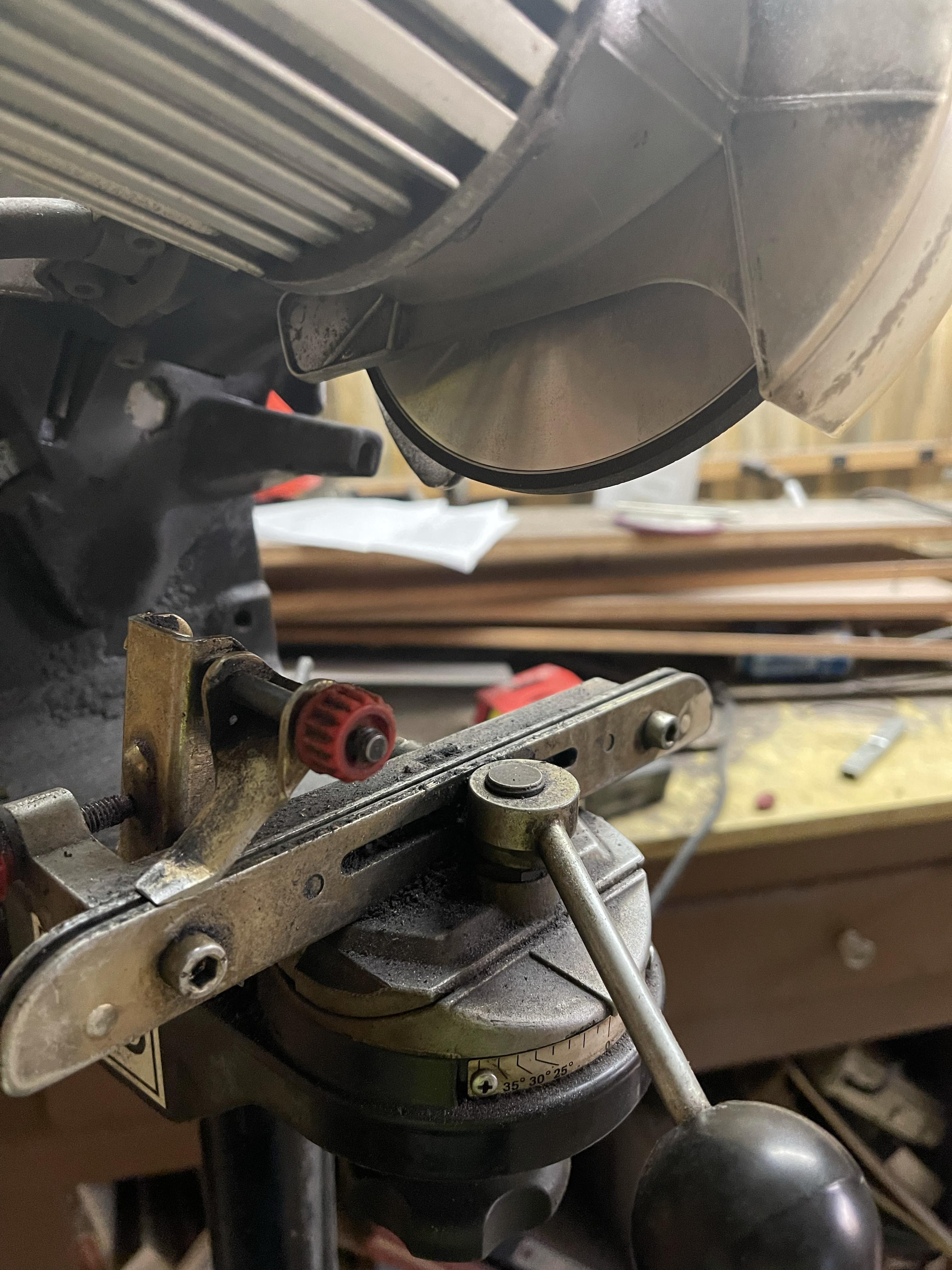

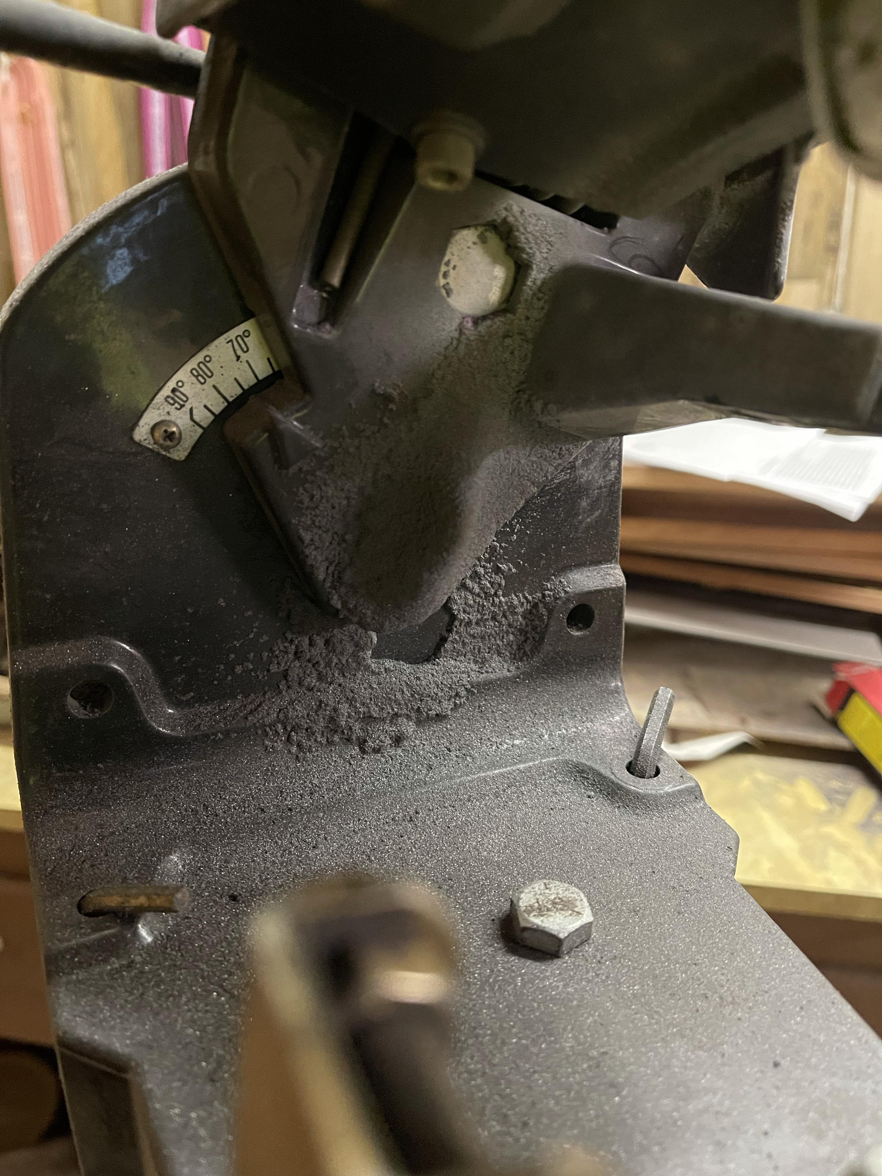

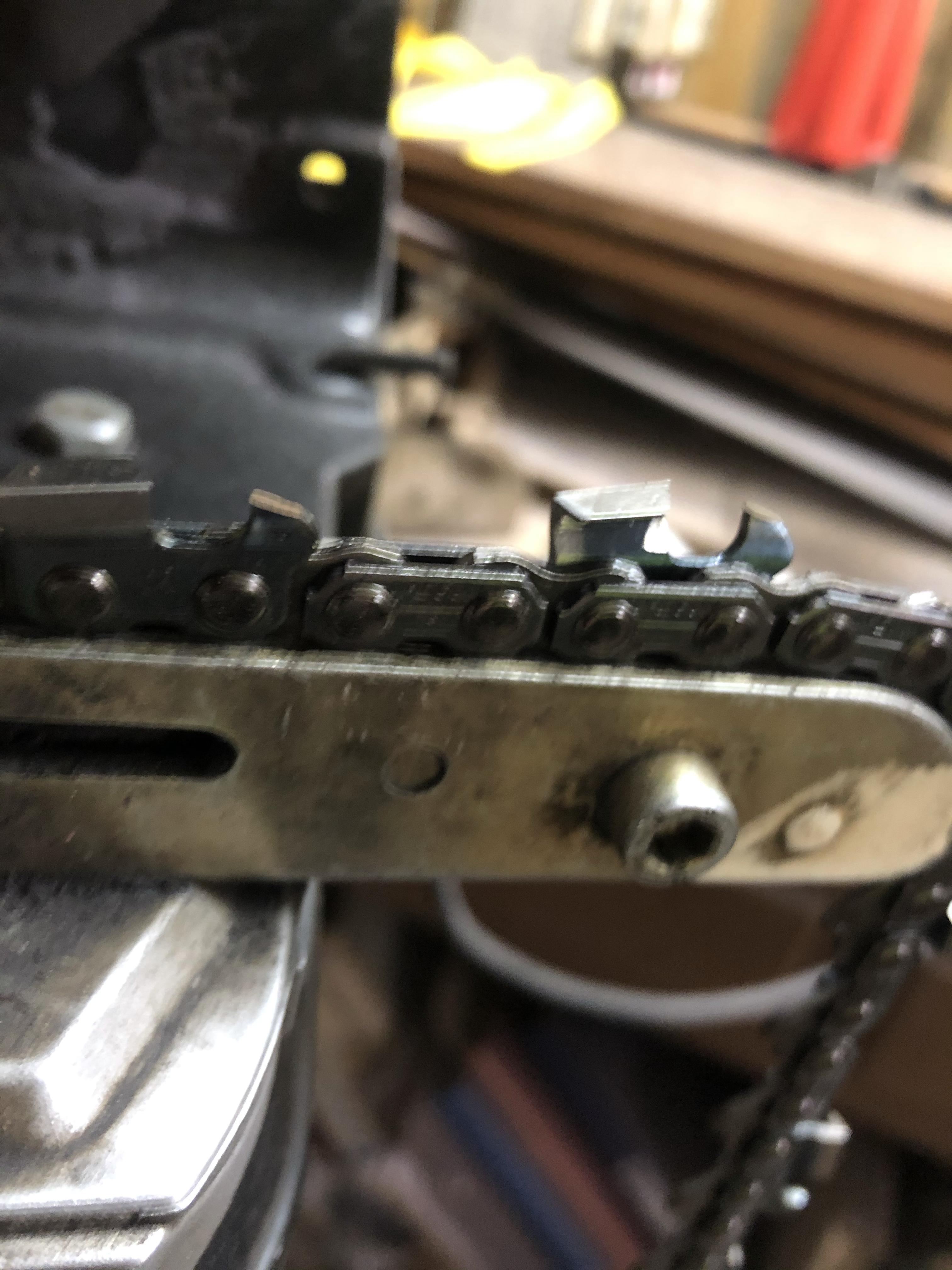

Here’s one way I do depth gauges and have for years for falling timber as well as harvesters. Now this grinder is only used on short chains 84 driver and down the main grinder that is used is the Silvey depth gauge clone.

Those look a lot better than mine. I think this grinder might bet the best thing to happen to my mill setup.
