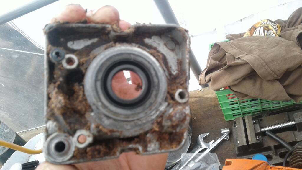

If its not that ruber thing could it be the meatal surface around bearing. Thinking about it ther was no gasket i think

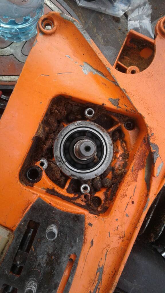

I found it. Inbehind the metal plate on clutch side. Thers a little ruber seal thing ther for the oiler ( i think).
Glad you found it! Yes, an O-Ring, no problem getting them from Husqvarna. Might consider popping in a new set of seals while you're at it, they're pretty inexpensive and a good thing for a saw of that vintage and easy to do, just note where they are placed now.

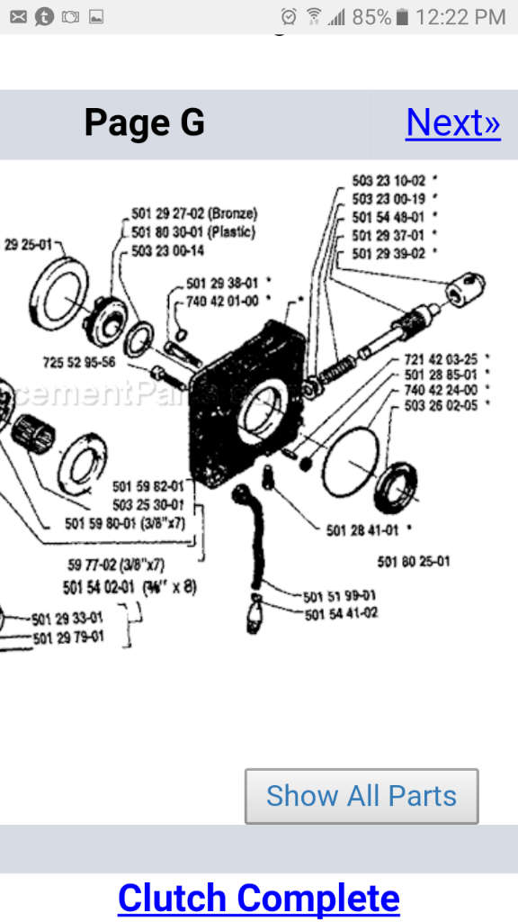

So should ther be a seal where the two metal surfaces meet. I gonna guess ther should be.

Found this diagram. Is this o ring seal the two metal surfaces.
Part number 740 42 24 00. If so it wasnt even ther.

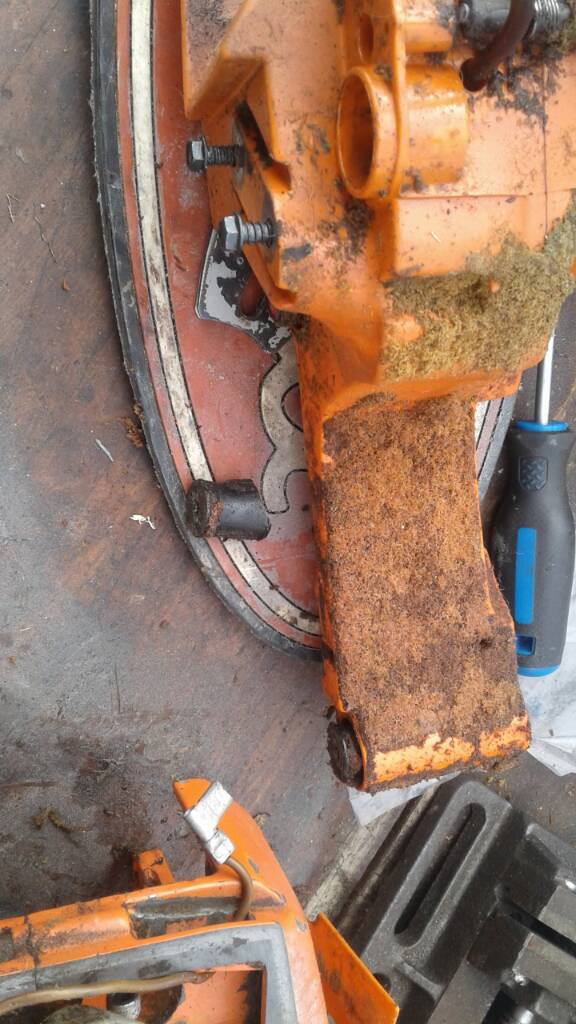

Any idea how to get tje broken antivibe out. Looks like its probly pressed in.

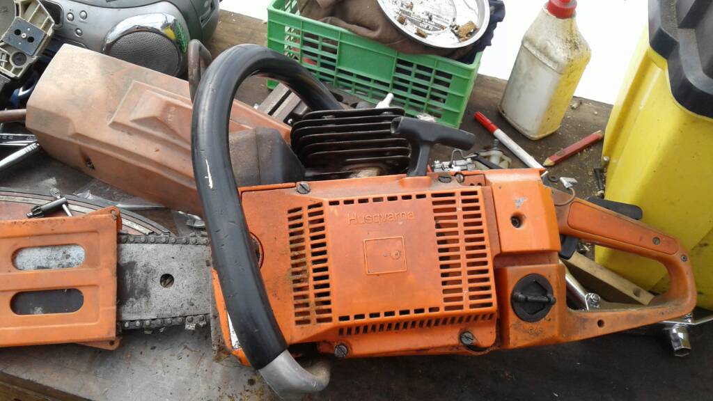

danimal
5:25 AM
1152
Apr 12, 2016
1,122
3,224
Armpit of da Midwest

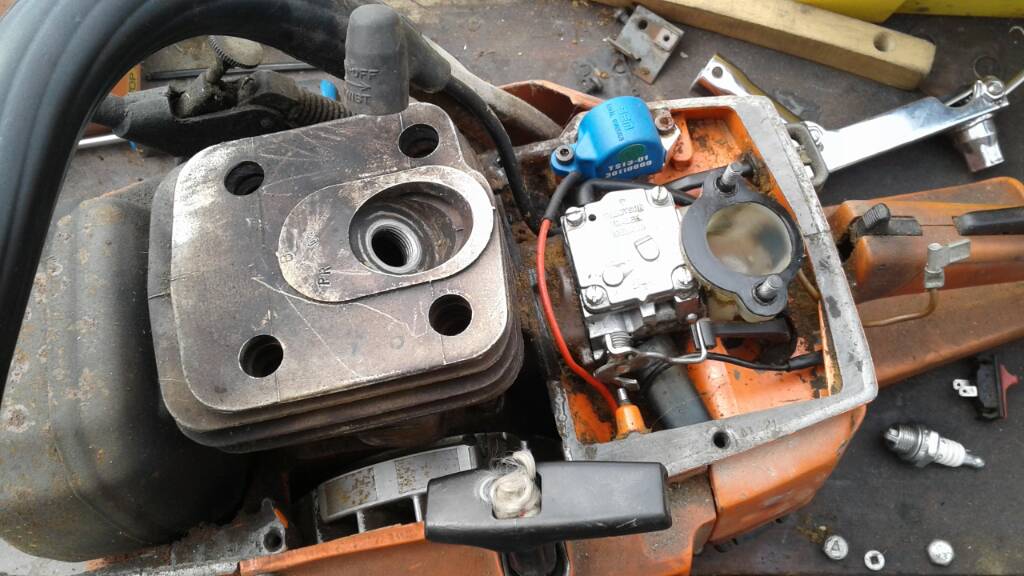

Working on a friends saw that he had given to him. I guess the saw was used mostly for cutting holes in ice for ice fishing.

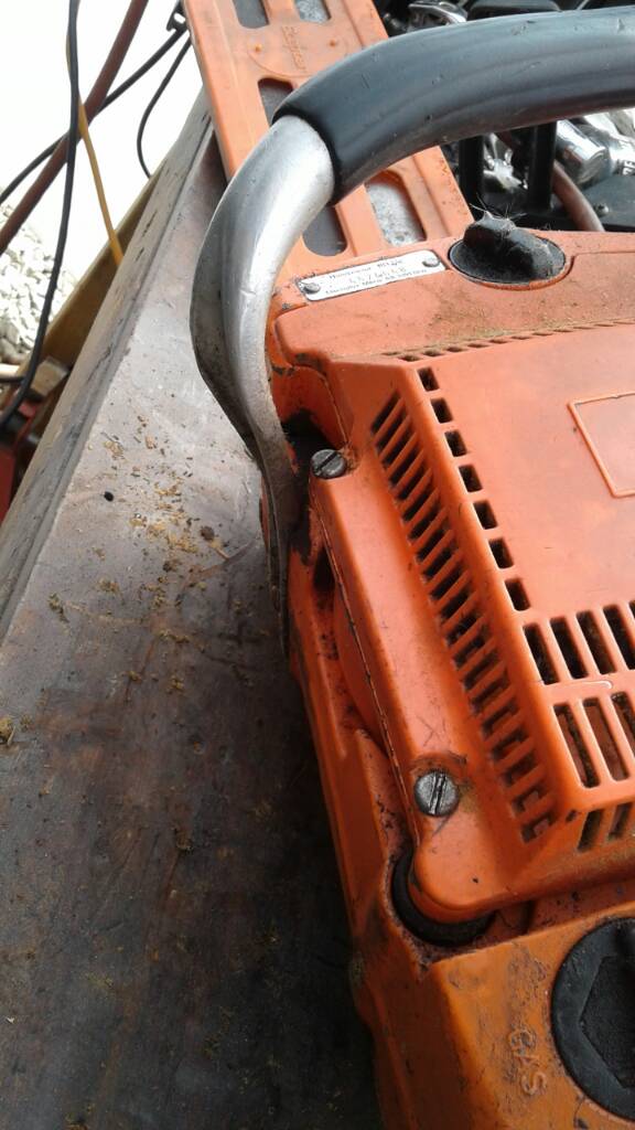

Any how at a quick look the on off switch is loose. Cant see how it fastens. Someone on another post showed a pic of a small screw but dont see it on this one.
The half wrap handle is bent will try to straighten.

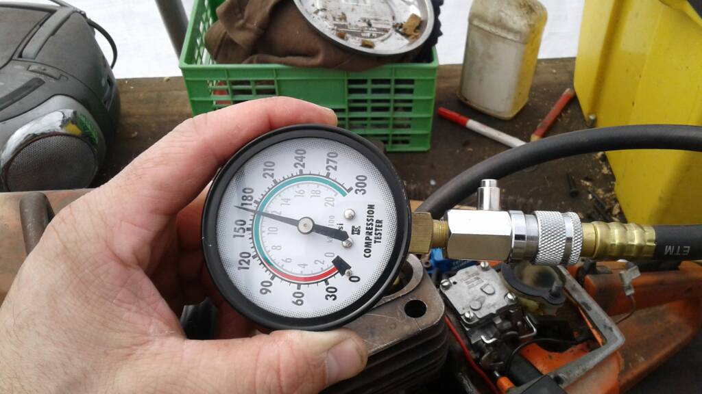

It has spark and compression.
Think i will grab a carb kit clean carb and go from ther. Try to fire after that and hope it dont need any seals.
Will see if i can get the muffler off without breaking the bolts to check cylinder too.
Dem things R junk..
I'll offer up sebenty five dollars, consider it a parts saw...
