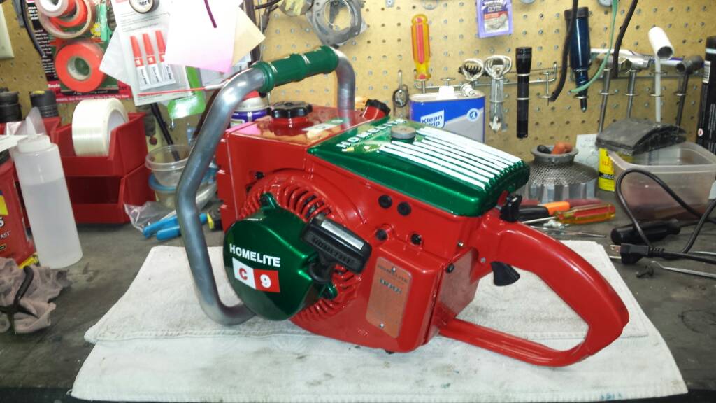

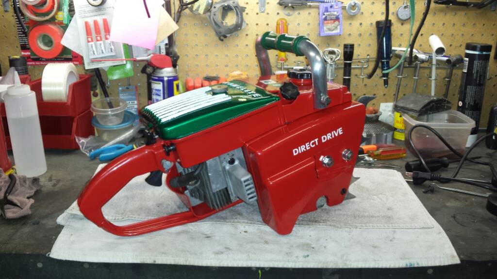

In the winter, I manage to do some "restoration" work on my projects. I have a nice bead blaster and it is integral to the process. As is the woodstove!
I generally degrease my parts, and wash with soap. Dry by the woodstove. Then, I bead blast my parts to bare magnesium.
Mufflers get tossed on a bed of coals and cooked for 15 minutes - then pulled out to cool before blasting.
The goal is to not contaminate my glass media.
After blasting, parts get hung on wires on a rack next to my woodstove. After heating, they are ready for priming and painting. Heat helps the primer and paint flow out smooth, and dry faster. It also seems to harden the paint a bit, making it more durable.
I like using my saws. I don't mind if the paint wears in, and don't see the value in powder coat unless it is going to be a showpiece.
That said, I finished up this recoil today. It was in rough shape operationally and cosmetically. I replaced components, refinished the paint, new sticker, and Chiwainese elasto-start handle.
Share your projects and methods!
