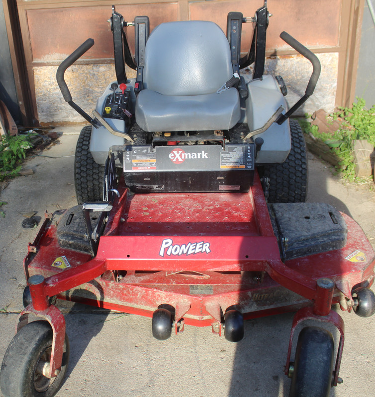

I am very happy with my fleet of mowers. I have my big ExMark 60" deck I use 90% of the time and do some commercial mowing with it.
5th year and only so far have had to do routine maintance on it.

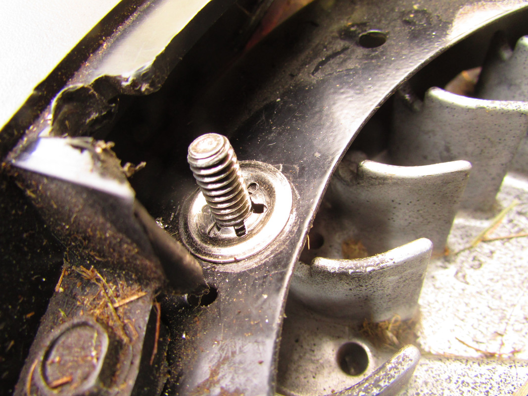

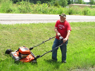

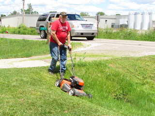

My ditch mower right now is a Husky AWD with a briggs engine. The recoil on the engine was crap and I had to make a crappy mod on it because I didn't want to have to carry my cordless drill in the truck to every job site.
Yes the banks are steep so I wear base ball cleats so I don't slip. OH also have the oil leval a tad over full.

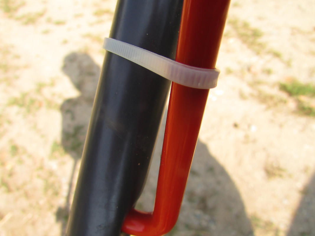

Use a zip tie to hold the dead man switch down.
Use the cordless drill to start.
Under this pile of JB weld is a plastic washer that gives and won't hold the wings that pop out the spin the motor. The JB weld stiffens up that washer.

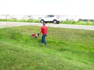

I suppose most people wouldn't start the mower in a year what I start it in a month. I do a lot of ditches for people.
The recoil is held on with pop rivets too. I drilled it out installed 1/4 20 one inch bolts. Found some flat washer things like used in the old days to hold brake drums on cars, used them to hold the bolts for the recoil. Worked great.
They will drive by while I am doing one and stop/turn around and ask if I could do theirs. Look at theirs and give them a quote. Haven't been told no yet.
One in the picture is around 150' long on the south of the drive and about 50' on the north I charge $30.00 to do it.

That entire shroud and recoil assembly was a major back step by Briggs.
The Riv-nuts that hold the tank onto the air shroud are bad to spin when you need to remove the recoil.
And I use a nut driver, by hand, to loosen them.
That new recoil is flexy and the steel in it rusts waaay worse than the old ones ever did.
And I personally never liked having the damned dipstick attached to the shroud.
The old style centrifugal ball ratchet was easy and simple.
Pull the shroud once a year (need to clean out the detritus build up anyways) and oil the felt in the center.
Ah but people would run them dry and squealing like a stuck pig till they seized on the crankshaft, broke the rope and twisted the guts out of the entire recoil assembly.
So now we get the new, disposable as a unit, one.
Seems like Tecumseh lead us down that road before they went under. Nice parting shot.
I've got a couple of motors with that new type recoil on them that I'd put an old style, notched, rope cup on 'em
IF the hardware store still had any.

Interesting idea with the push washer things to hold the 1/4x20's. I got all fancy and tack welded some T-nuts under the shroud.
Do a good cleanup prep so that the welder arcs nice and easy.
Using smallest solid wire you can run. That flux core stuff just splatters too much
Snip the end of the mig wire with your cutters , or the ball on the end will try to skip a little and miss the edge of the nut.
Run a screw into the nuts and shroud and a quick tap of the mig gun should hold them.
Make sure the screw doesn't stick out past the nut or a dingleberry will danged certain find the threads and then you can't remove the screw after the weld.
You may need to stack a couple of washers temporally to get the backset of the screws.
