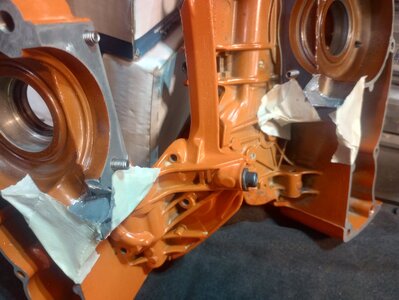

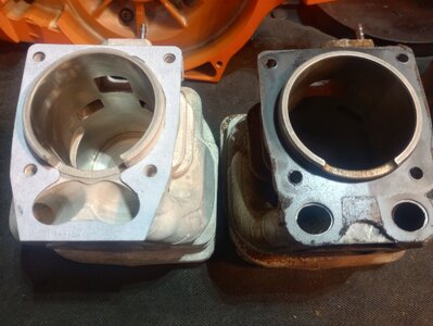

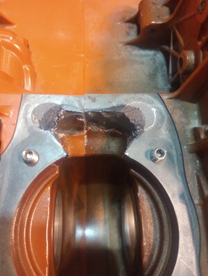

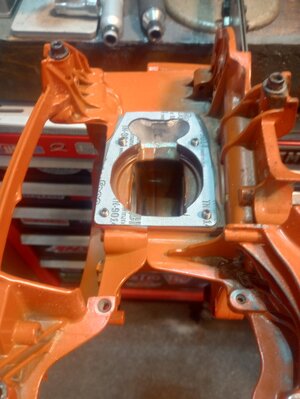

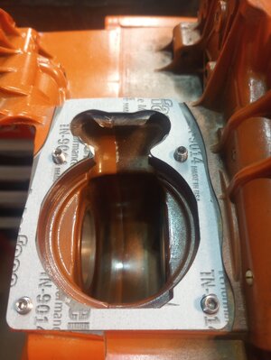

I had an old loggers junk 575xpg laying around for a while now and I finally decided to see if I could make it into something decent and usable for myself. I am in want of a bigger old man saw basically, that starts easy, has low vibes and decent enough power to pull a bit longer bar if need be. As of this writing, there's not a lot of support left for these saws, there is however some left for its close cousin the 576xp. Here's where we get into the fun part. While there may not be a huge difference between the two saws running them, the 576xp does have an improved lower transfer system which is the main difference between the two. This could be an advantage as I plan to port this saw, so it could pay off dividends later if I could make a 576xp cylinder work on the 575xp chassis. Question is will it work and be a legitimate saw when finished?
With my search engine locating me a reasonably priced new OEM 576xp top end and having to pull apart the crankcase anyway to replace the frozen crank with one from a near new 570 along with one fly side case half as long as I was at it to eliminate the repair on the old. I have the tools from Husqvarna already here for disassembly as well as assembly. So, might as well give it a go and see where it takes me.
The hole patterns of the top ends are the same along with everything else but the lower transfers. Here's how that story unfolded....

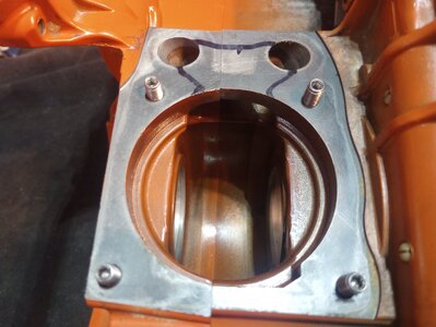

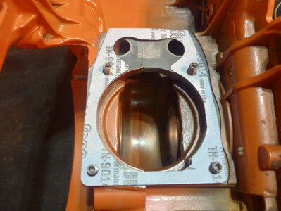

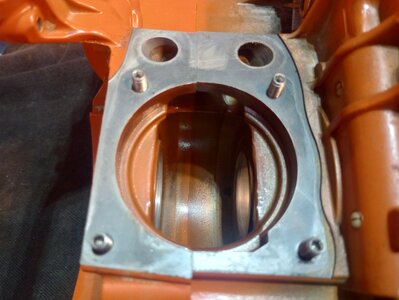

There you have it folks, all ready to accept the "updated" 576xp top end. I think now you can see why it's not just a plug and play operation. It's also not for every situation either. If this were just a simple top end swap, this probably would have never came to be. Also, for folks that have the tooling to work on the cases. But, for the person that just happens to tick all those boxes like I just happened to, it may be something you would care to try.

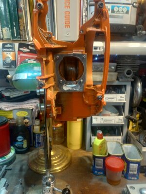

This is as far as I've gotten, so for those that want to see the end product will have to wait as this is something I do in dribs and drabs in my spare time, as well as acquiring the necessary parts to complete. When that day comes, I will do a follow up.

One more thing to note, the case alignment pins are loose in the 575xp side case and not snug in the replacement 570 case half. Allowing the cases to go out of alignment at the cylinder base. My plan is to A, grease the case gasket and B, dab some threadlocker on the pins when installed and C, bolt on the cylinder just prior to the final tightening of the case bolts. While this is a rare thing to encounter, it needs dealt with or leaks can be had from either the misalignment or the breakage of a case gasket when it shifts.
(Greasing the case gasket is nothing new, or even a trick, I learned it from Husqvarna repair manuals.)

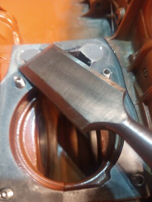

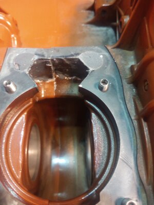

A sharp flat chisel took care of any flash.
Another go with the marker for final finish.
Is that a porting chisel? :p

Well, I use it to scrape gaskets off on saws, some get ported, so, maybe?

Design changed for better flow up through the transfer ports, so an improved design, best I can tell.
Don't know on the rest.
I can measure the ports to the squish band and see if the 575xp and 576xp are similar or not and get back to you.
I do have a set of stuffers and can eventually check them out for other fitments as the opportunity's present themselves.
