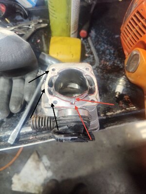

Hard to say if you have a problem in these spots, but the PTO side doesn’t show much sealant (black arrows) and there is a fair bit of sealant near the pulse that could interfere (red arrows).

Not overly surprising to have different thicknesses of schmoo, when you consider that the base adapters are notorious for warping.

Did you grind down the plastic ribs on the right side of the case so the cylinder does not touch the side.
If you have a base gasket , maybe try running it with just to see if it makes any difference. Could be a slight warp in the bearing cap or the plastic case itself. But you did say it passed a leak and vacuum test. It could be developing a leak when it all warms up after a few cuts.

Throw a gasket in after cleaning up all the schmootz, might tell you if it was lack of sealing on that pto side.
That's a good idea if backing off the timing a little doesn't help I may take it back apart and put a gasket in it just to rule it out
