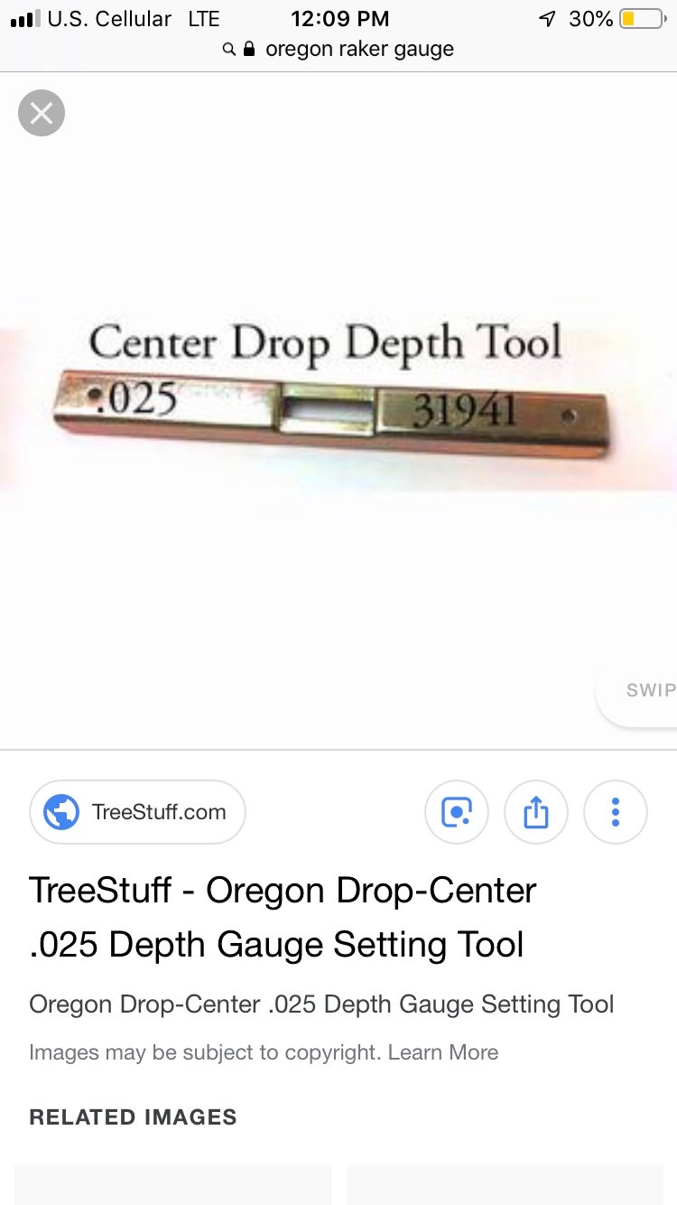

I'm in no hurry, just trying to see if there is something better. The oregon gauge is "fiddly" and I constantly question if I'm using it right, same as the Husky roller setup.
