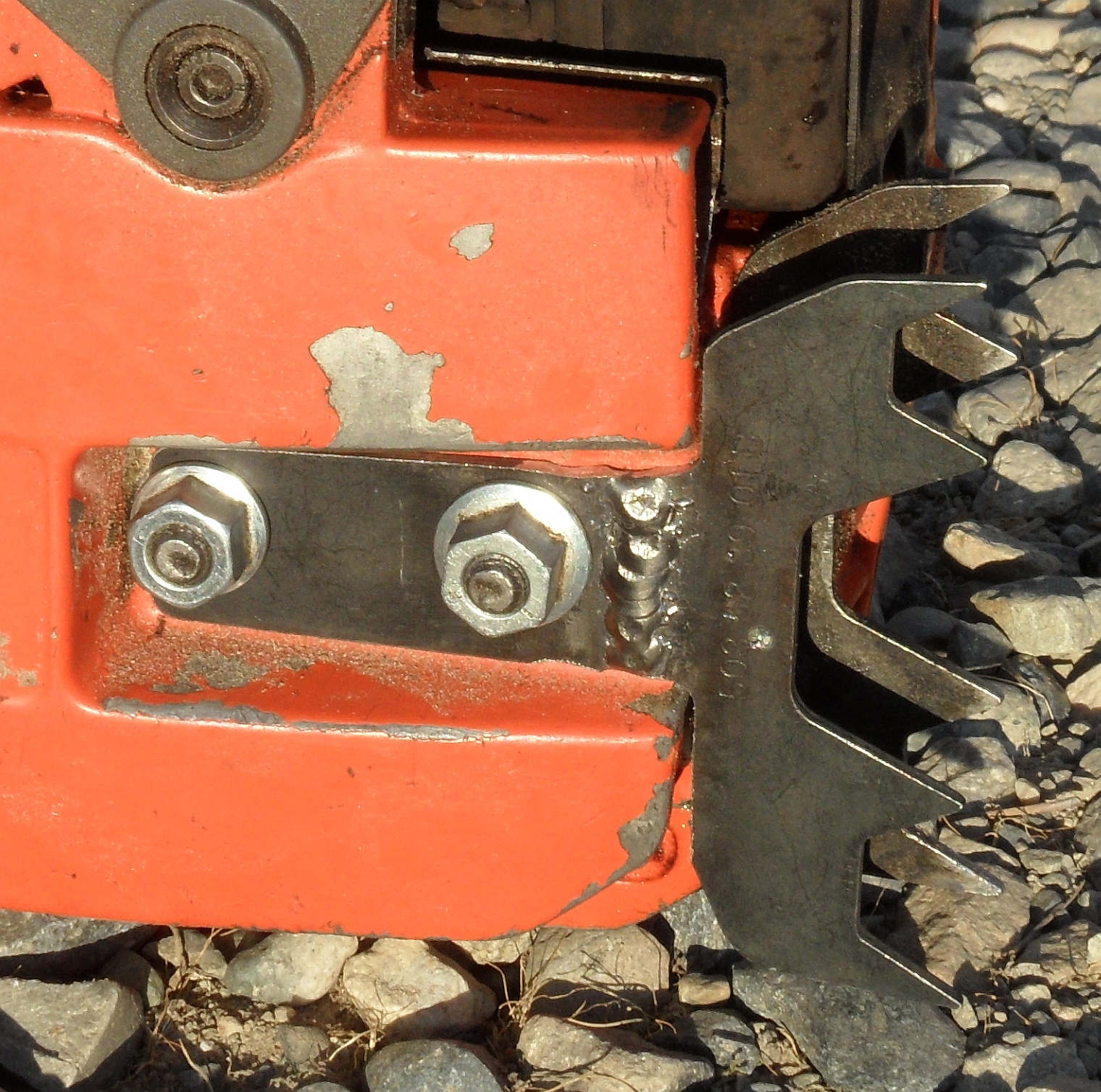

Does your inside spike not quite match your outer? It didn't on mine. I took steps to resolve that issue.
Yup. The outside one sits a bit farther forward. There might be enough room to grind the holes forward so the dawg slides back to match up. As long as there is not up and down movement I think it would be OK. I have to check later.

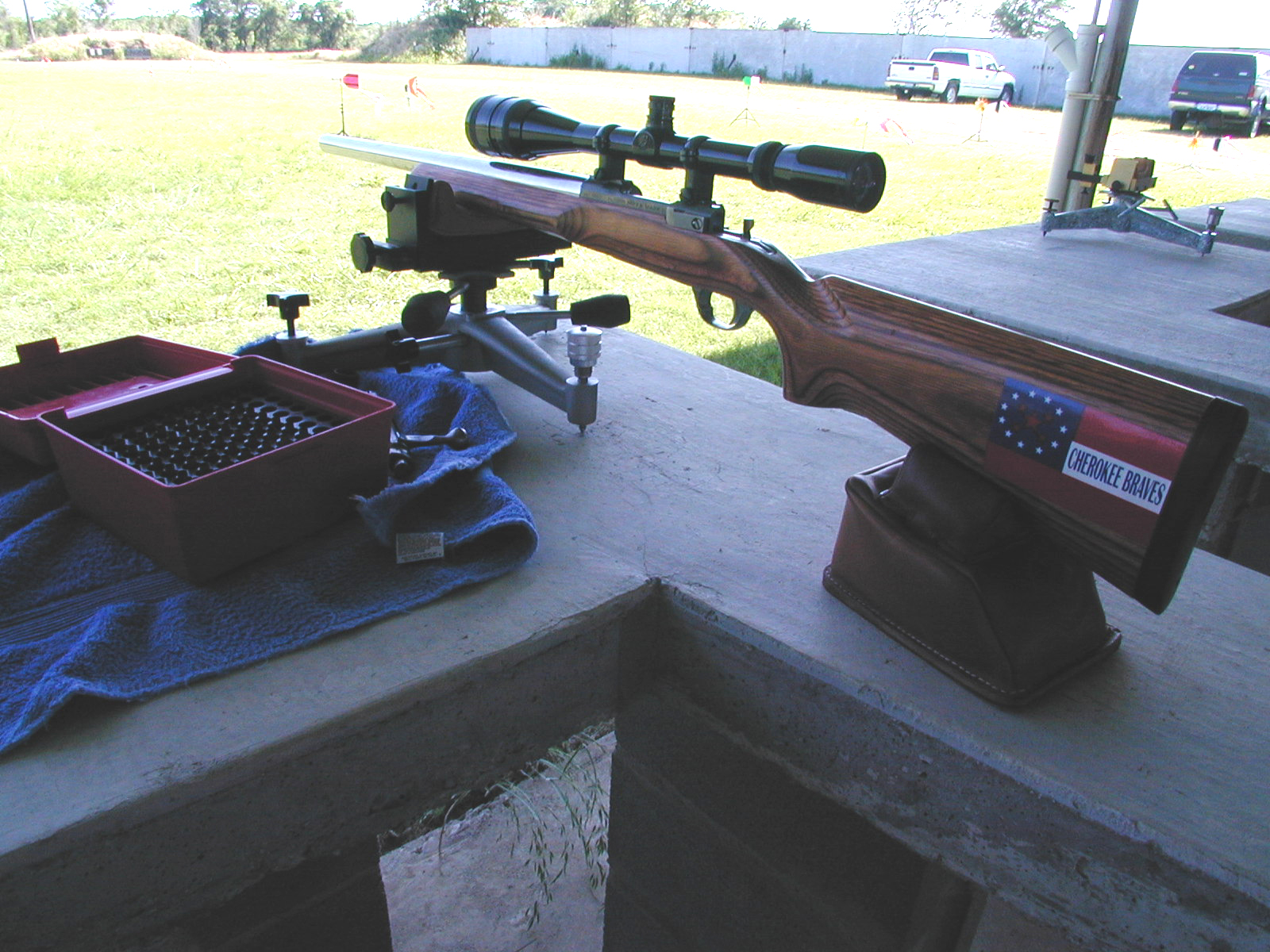

Here's the rig I was using that day - one of my actual varmint hunting rigs. Speedy was still building my target rig.

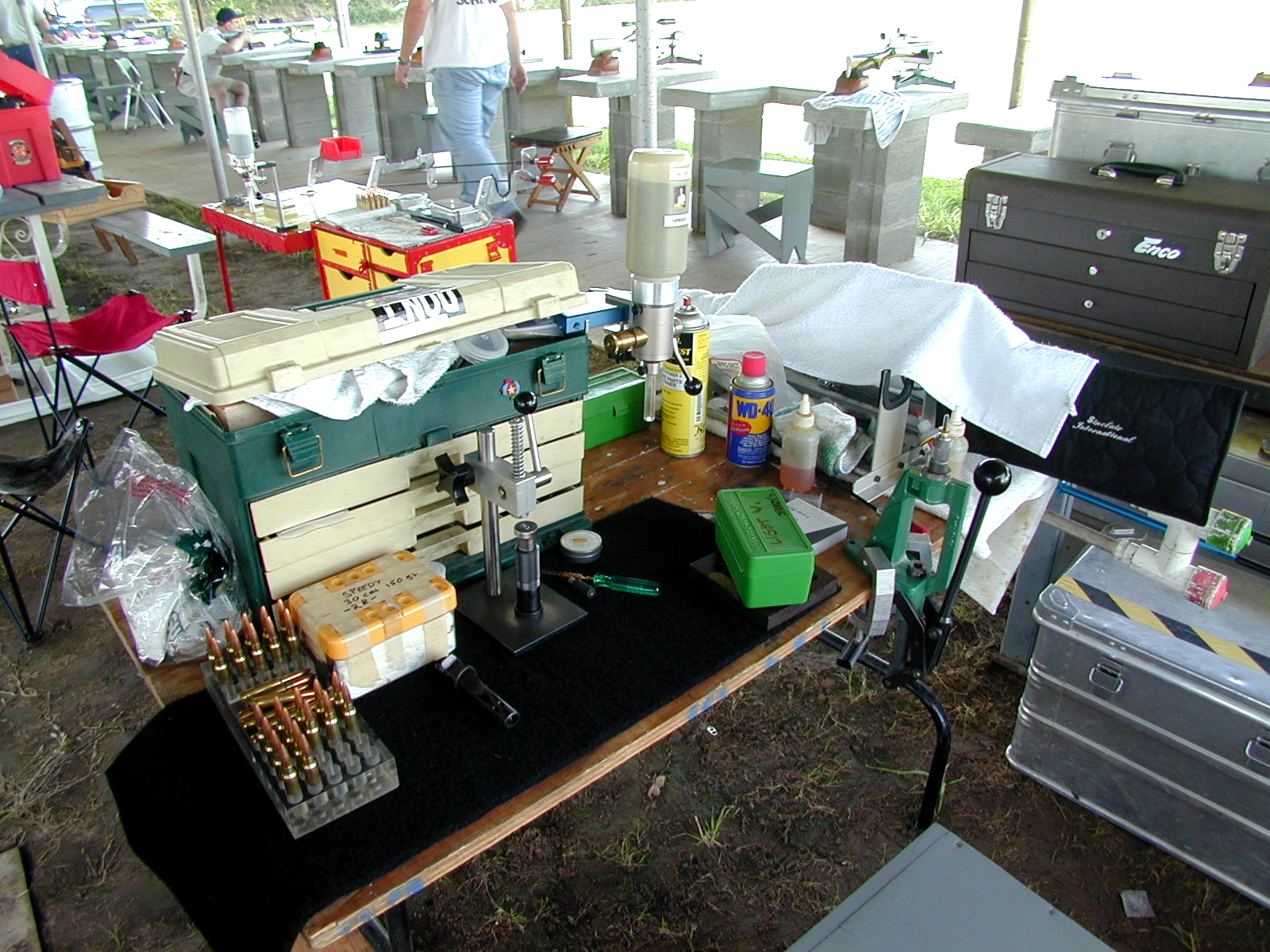

Some folks are more serious than others. Some are testing. I just shot what I brung. Here's Speedy's bench:

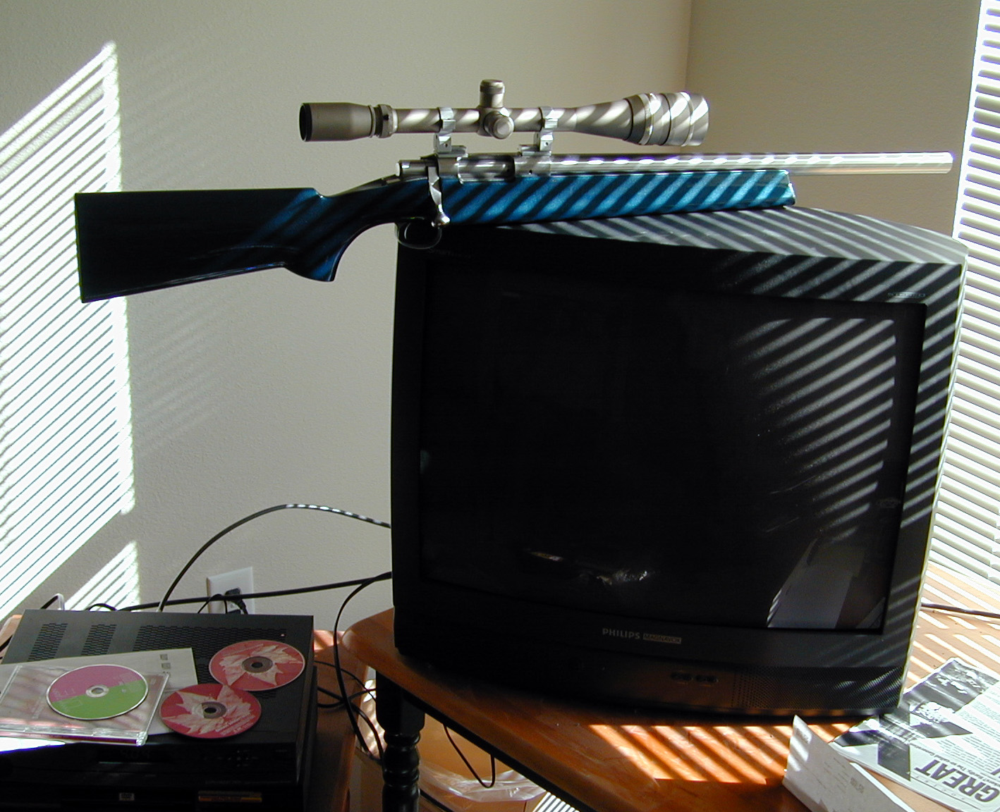

Here's a pic of my competition rifle. It cost more than most of the cars I have owned:

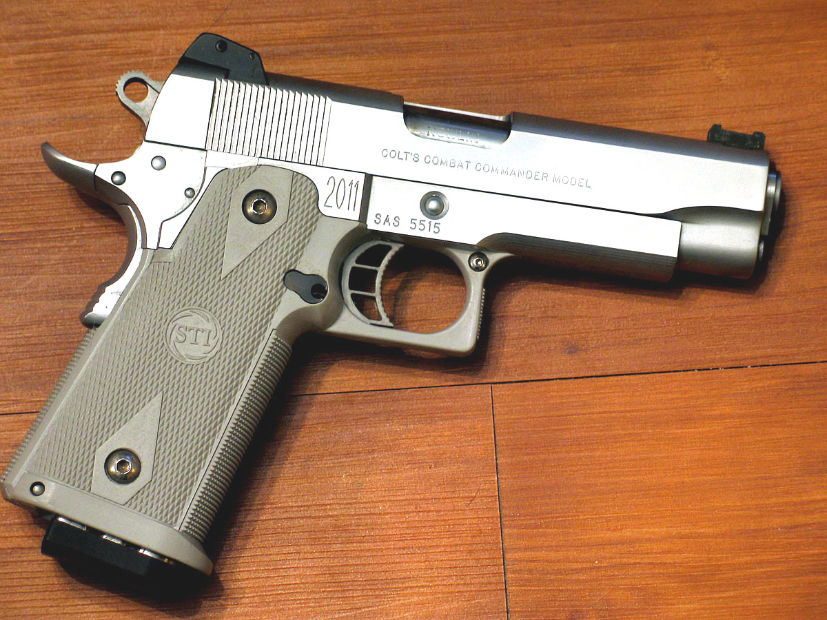

My handgun competition rig - I used to live around the corner from STI. I qualified for a handgun carry permit with this rig, terrifying most the other shooters since I made one tiny hole with all 50 rounds we had to use:

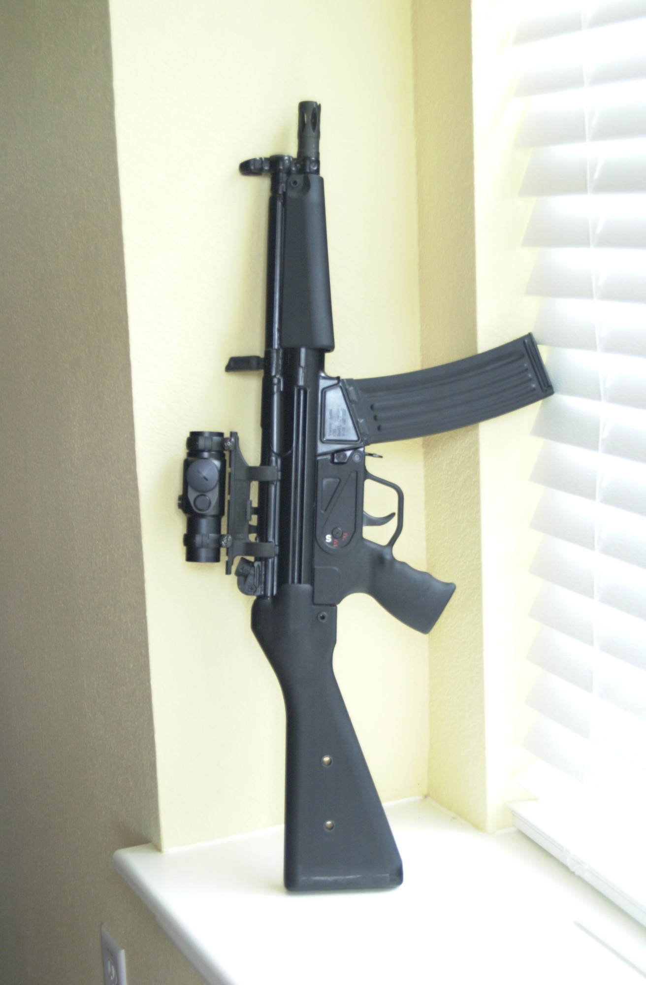

And what I used when I didn't feel like having a competition:
That's an H&K 51 5.56mm, fully automatic. It had a 9 inch barrel and spewed flames all over the damn place in full auto. Very expensive gun to buy and feed. :(
