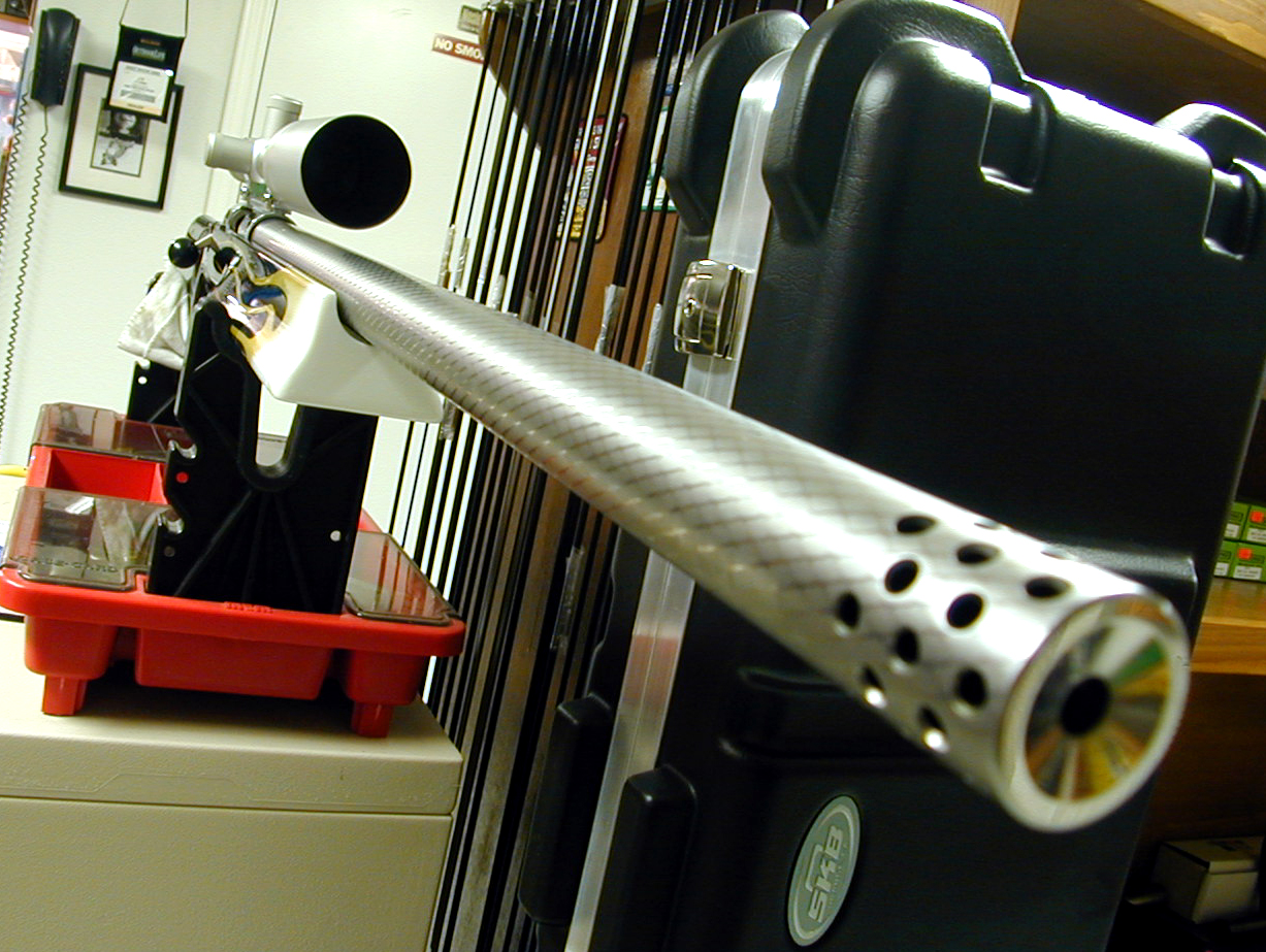

Cryo treating was huge in my area in the late 90's. I used to shoot benchrest rifle competitively. I was pretty good at it, and have beaten many legends in the field in club matches(which just shows I'm competent, as they were likely testing stuff as I was).
Never noticed a difference between cryo and non cryo treated barrels, or actions. Didn't notice any more smoothness in operation, any longevity increase in barrel life even with some of the crazy rounds I was using in varminting like the 243 AI pushing 70g bullets to 4,000fps or the 300 SAUM that I hated shooting, or the 220AI Swift which propelled 40g bullets to 4200fps.
They all wore about the same and had about the same accuracy. But guns ain't transmissions. ;)
What made the biggest difference, and by far, was treating the bullets and barrels with moly. They lasted half again longer, and were not more accurate - but were as accurate for longer before needing a cleaning. So for competition, I always used it and never cleaned my barrel during competition. I also noticed you could up the size of the powder charge a bit as well, which would technically make it more consistent form round to round. From my chornograph, it did show less variance in velocity, but I didn't notice any more accuracy over all vs no moly. But, then again, all my barrels were cusotm made, hand lapped and broken in carefully, which might be the most important part.
