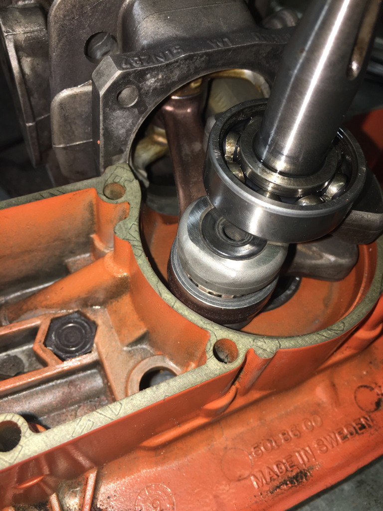

I set it on a large socket in the pot, so that it’s heated by the air and not directly by the coals. We don’t want it to heat to quickly, or to get to hot.
Check it with the IR
Little bit longer. I shoot for 3-350
p61 western
Ol Mudflap
1:30 PM
2003
Oct 18, 2016
29,506
132,028
GFY
305 degrees dropped right in!
I set it on the cylinder for a place for the crank to go so I don’t need to hold it.
And a minor mishap...
I was gonna pull it off, but I thought it might be ok... whoops!
All better!

It wasn’t quite as hot as I wanted and it went 90 percent of the way, so I cinched it up with case bolts, and heard a pop as it went together.
Can anyone say why that is noteworthy?

Guessing the "pop" on assembly tells you that you should make sure the crank rotates freely because the bearings were getting side loaded. Just a guess
