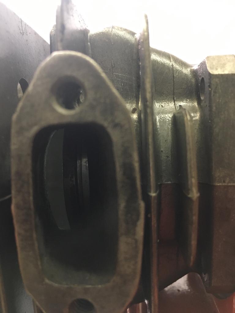

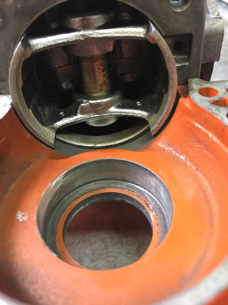

Taking a look at things to get an idea of flow patterns.
BDC
This is where transfers first crack open
This is a visual of how much blowdown we have
This is the orientation of the crank when they crack open
And BDC again
So you can see how important the piston windows are!
