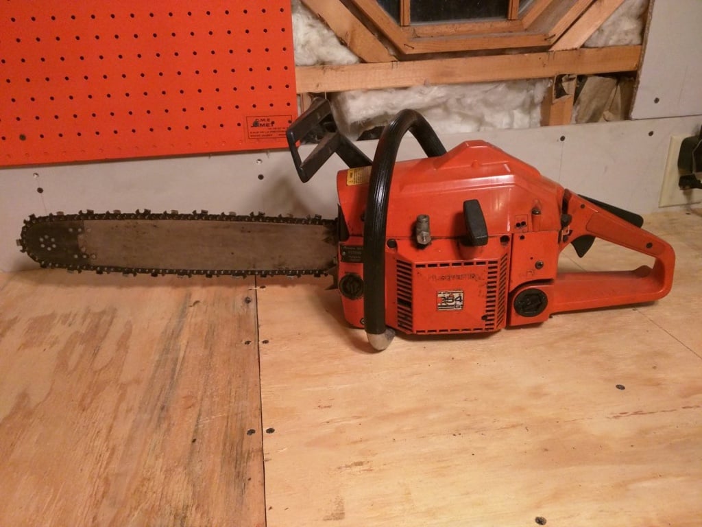

Yeah, its a '99. The first 3 are of the later one that I scrounged parts off my FG carcass, the later pics. The cover fits that one fine.
View attachment 211328 View attachment 211329 View attachment 211330 View attachment 211331 View attachment 211332
i would like to see more pics over both the 254XP-99 and the 254FG (special the last one.

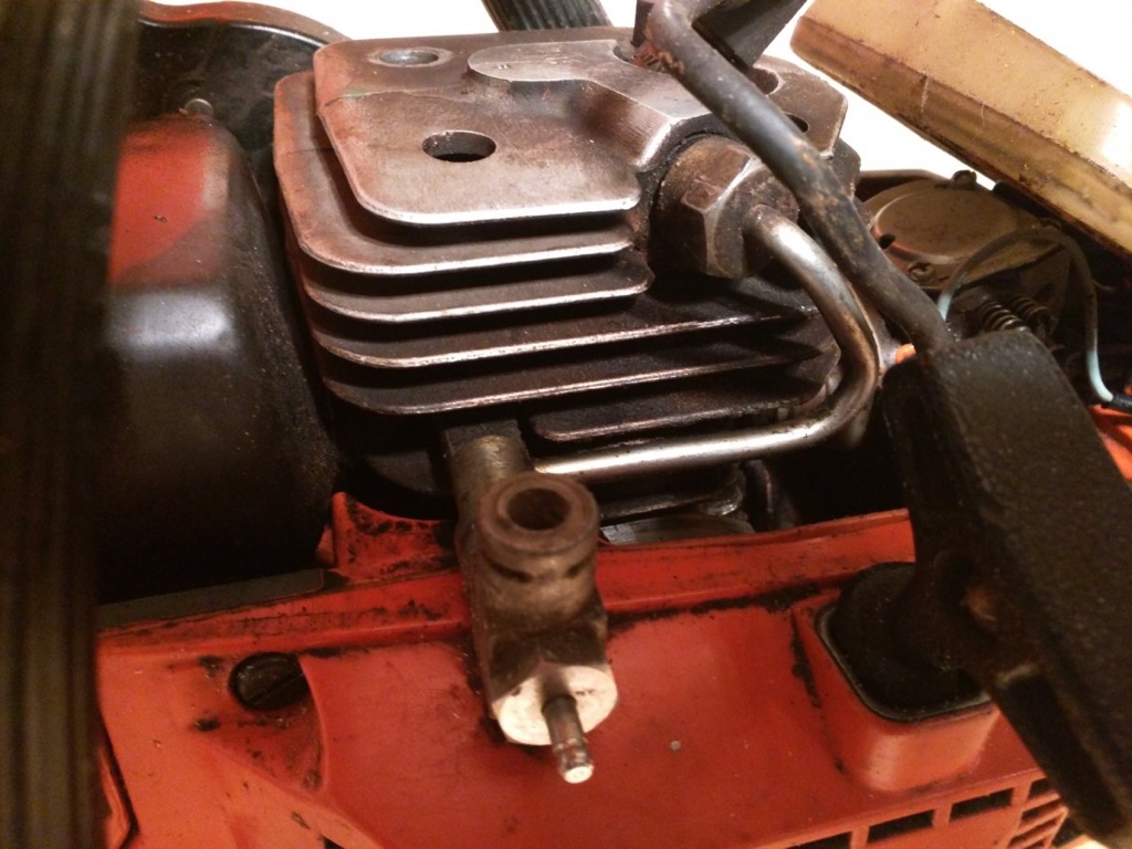

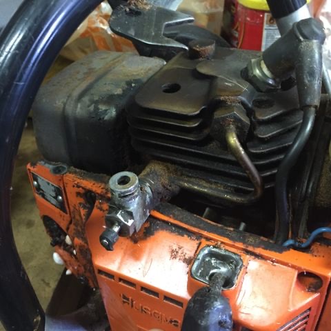

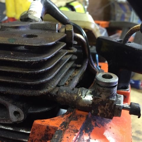

@Tor R , here are some pics. Let me know if you want to see somthing else. I dont think the generator works, hence they cut the lines to the handle, top and rear. You can see what they did to the Mordfeller attachment.

The FG has a special cylinder with a connector valve coming off the top that you could open/close, similar to the decomp valve. At the bottom of the valve was a hose barb that would run to an inflatable wedge. The idea was you would stick the inflatable wedge into the tree, connect it via hose to the saw, open the valve, and the saw would inflate the wedge. By the pictures, looks like most of the FG apparatus has been removed.

I’d be very interested to see the size of the combustion chamber inside the FG model, if you ever take the cylinder off. Just for my own edification, because the very early 254 cylinders had small combustion chambers. I’d also love to know what the casting marks on the bottom sides of the cylinder show: is it a KS or a Mahle cylinder, and what is the code?
