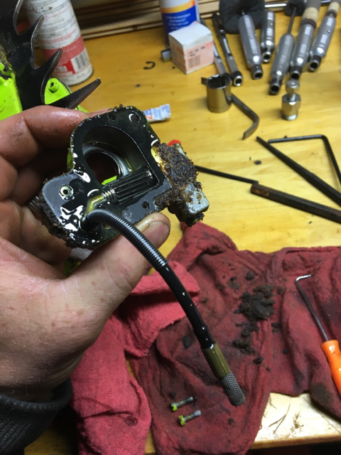

Digging into a counter vibe 4400 that won't oil more than a dribble. Any idea what to look for as I open her up?
paragonbuilder
7:44 AM
384
Jan 2, 2016
9,229
33,871
Norwich, CT
Filter is clean. I can blow through it.
paragonbuilder
7:44 AM
384
Jan 2, 2016
9,229
33,871
Norwich, CT

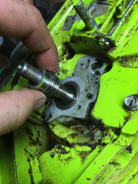

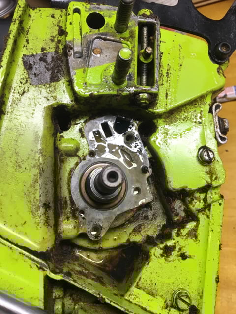

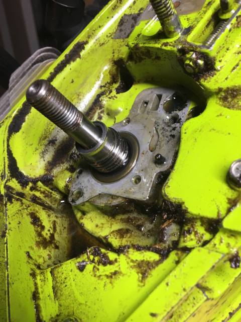

Pump seems to work when I turn it by hand.
But this is where I'm confused.
This gear
Just spins on the crankshaft. Is it supposed to be press fit? Or how does the oiler get activated?

I think you found your problem. Looks the same as the one I just had to remove on a 262. It was anything but loose.

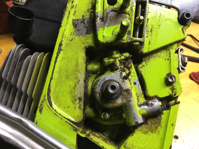

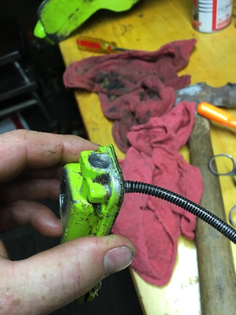

This guy is cracked. I put the hose in the oil and spun the pump. Constant bubbles. I pulled the cap out.
If I cover this with my finger, no more air!
So a little sealant and she should be good. I'm guessing that gear is tightened down by the clutch and that keeps it from spinning.
If I'm wrong please enlighten me.
That's why I thought that myself, just pulled a 262 apart myself. But now I'm thinking the above. It used to work fine. And the gear is just way to loose to ever have been tight. I think anyways...
Unless of course it's activated by the clutch.:)

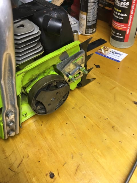

Nope it's not activated by the clutch. It constantly oils. I spun the clutch assembly on hand tight and I can no longer spin the gear.
So tightened down it will be secure. I'm pretty certain now that the air leak was the issue. I was thinking back to last spring when I ran it and we couldn't get it to oil. Just lots of air. Pretty sure this explains it.

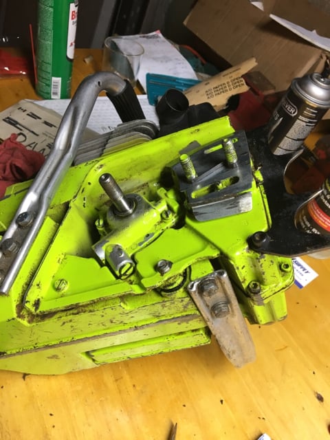

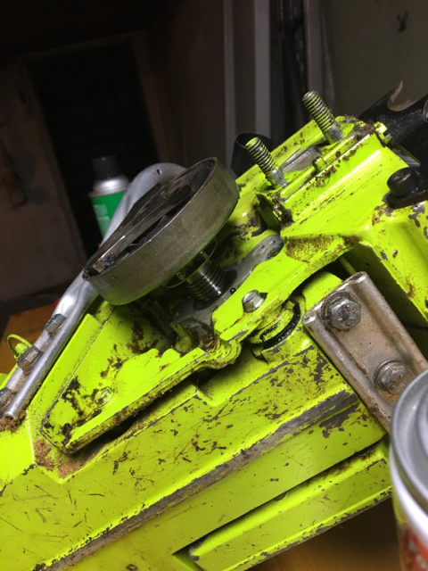

Going back together

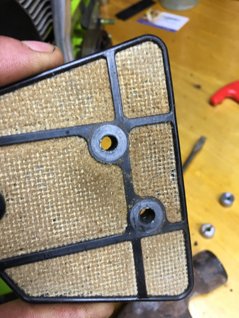

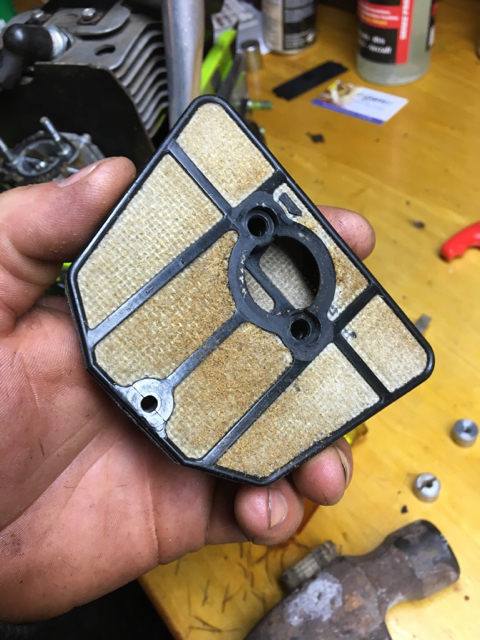

Pulled the air filter to blow out the fines.
Not to thrilled with the way the flocking looks. Time for a new filter. But wow! Look at the size of this carb
22.1 mm!!!!
