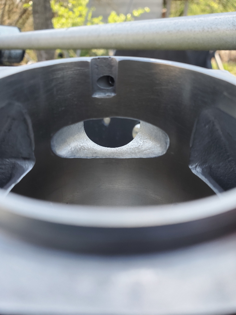

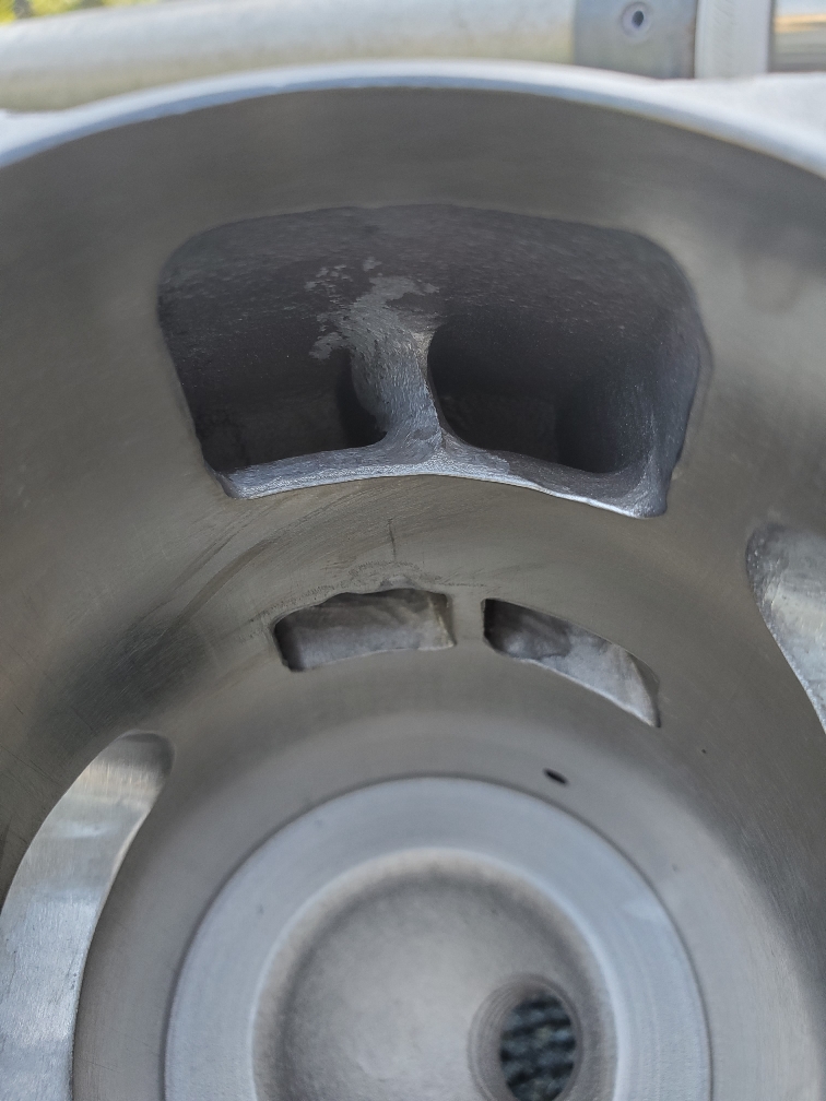

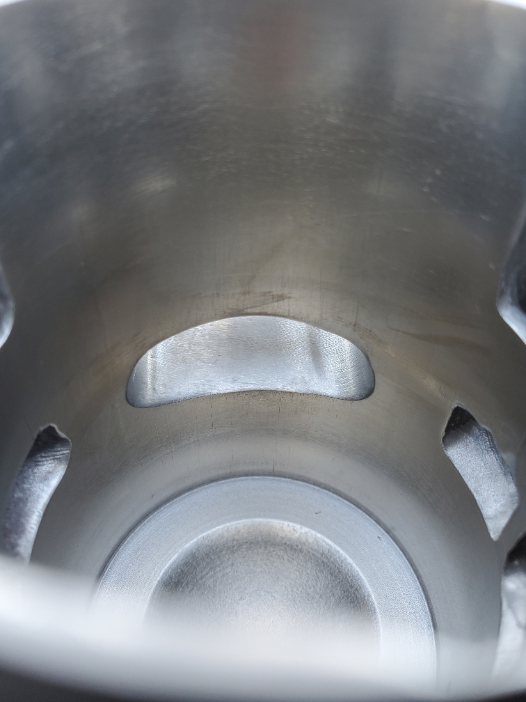

Just finished up my 395. Not sure I'd consider it art work though! Learning more with each one I do. Still making mistakes but less of them. Should be running in the next day or two. Thanks to all who helped me with this one!

Numbers as it sits
82 or 83 intake- It's 82.5 ish
110 exhaust
136 secondaries
140 primaries
Will end up
82 or 83
100
125 - 126 secondaries
128 - 130 primaries
Sumptin lik yat

Do fingers essentially create a primary and secondary?
Redfin
Meh...
12:59 PM
159
7,653
40,039
Central Pa
I would not say that. The key to quads is the direction they flow. Fingers are more for transfer area and flowing tail end of scavenge loop.
mettee
9:59 AM
5872
Apr 10, 2018
1,425
5,405
Arizona
Okay I'm wrapping what little brain I have around that :)
